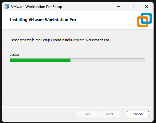

I recently downloaded VMware-workstation-full-17.5.2-23775571 and tried to install it - it gets nice and far and then just sits and doesn't move.
It installs nicely till I get to to a point where the Virtual Network Editor pops up and immediately goes (Not Responding) and if you leave it, it (the installation) eventually fails.

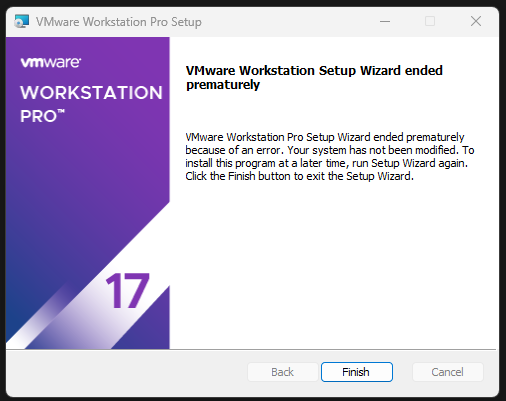

If you force close the VNE window - installation fails with the following error:
And then the inevitable image appears
Can someone please guide me on how to fix this - all the searches are old and nothing works and we are now mid way through 2024 and I don't see how this can't be fixed.
