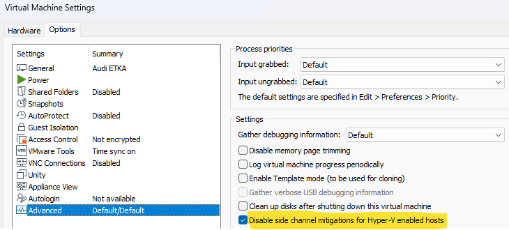

Check whether this setting below is different between the two hosts. On Windows 11 host this should be checked for all VMsm unless you disabled Hyper-V. But I don't think that would make the process run in efficiency mode. Also: https://devblogs.microsoft.com/performance-diagnostics/reduce-process-interference-with-task-manager-efficiency-mode/

On a Windows 10 client, VMware installed with NO VBS Mode Host, and using standard Microsoft Windows computers (both Host and Client), Side Channel Midigations disabled ... a rather OpenGL  graphics and database intensive standalone application works just fine. VMware version is 17.5.2.
