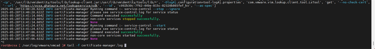

The import process starts and reports "Don't update service <service id>
then performs a rollback
in the certificate-manager.log the following is logged:
I have searched the internet for possible causes for the roll back, but any suggestions i have found seems to not work.
