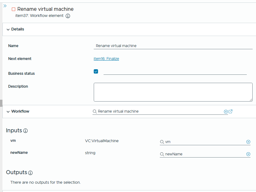

I'm trying to use the Rename virtual machine (And Rename virtual machine folder) workflow at the end of my other automation workflows to have the VM name in vcenter slightly different from the DNS name of the OS(appending -vm to it).  Any thoughts on how to pass the vm input (name) into the workflow from a scriptable task within another workflow so it picks up the vm as VC:Virtual Machine and will execute the rename_Task that is called from the rename workflow?  Add a workflow element for this adds the inputs but I'm struggling with how to pass these inputs from the previous task.  Would rather do it this way vs either a manual run or adding another task to do a powerCLI command if possible.

you can leverage the concept of workflow reusability. This involves calling the existing "Rename Virtual Machine" workflow as a sub-workflow from your main workflow. You can achieve this by using the "Workflow ID" or a reference to the reusable workflow in your main workflow.
