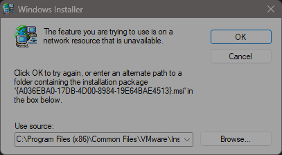

I have installed VMware Workstation Pro 17.5.1 and wanted to do an Update. That fails with a message box popping up and saying a {GUID}.msi File is missing. I then thought I could uninstall the old Version first and then install the new Version. But there is no Option for Uninstall if I go through the Control-Panel/Software or Settings/Installed Apps. I can select change, but then I run into the same Error.

The following pops up when i try to Update or run an VMware-workstaion-full-xxxxxxxx.exe
How can I remove VMware Workstation and then do a reinstall?

Hello Aa Aa. Thanks for you response. Strange format with your links but anyway that is exactly the Problem. I'm not able to use any installer. But i found a solution for myself. "The feature you are trying to use is on a network resource that is unavailable" error when upgrading VMware Workstation
It's not exactly the same components as for my situation but I managed to Reinstall/Update after removing the corresponding Registry Keys for my situation.

Could you try to use installer https://softwareupdate.vmware.com/cds/vmw-desktop/ws/17.5.1/23298084/windows/core/VMware-workstation-17.5.1-23298084.exe.tar to repair 17.5.1, then update, or uninstall it then install new version?
By the way I don't know if it will work that you install lastest version (to date (20250322) is 17.6.3) https://softwareupdate.vmware.com/cds/vmw-desktop/ws/17.6.3/24583834/windows/core/VMware-workstation-17.6.3-24583834.exe.tar
