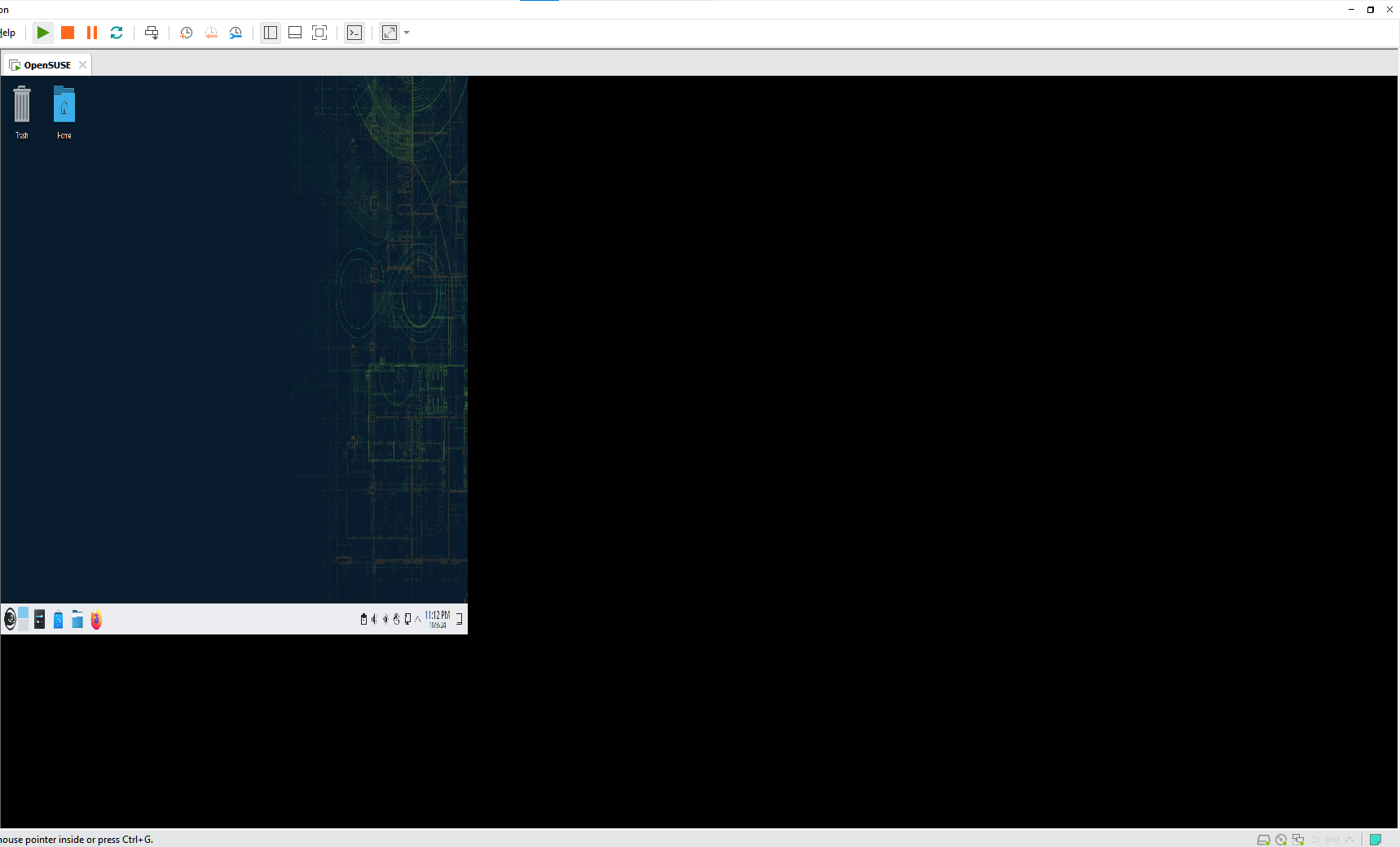

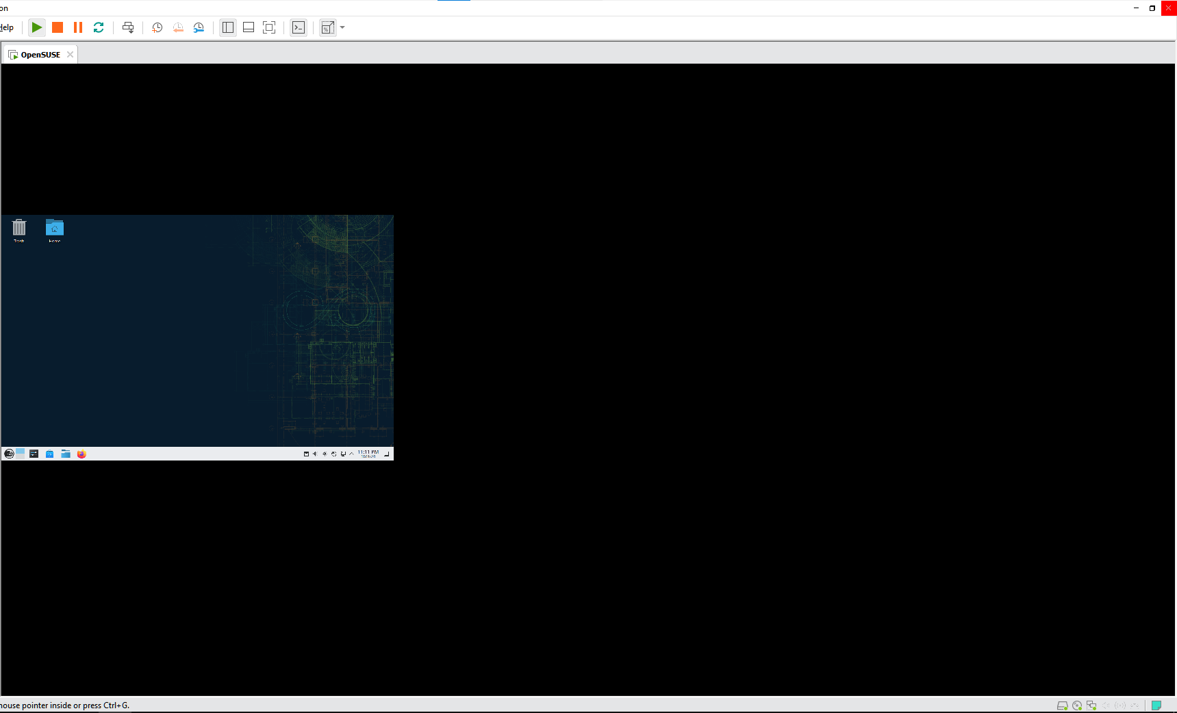

What's also weird is if you change to stretch view mode, it looks like VMWare Workstation still thinks there's a second monitor
(Stretch and keep aspect ratio):
(Free Stretch)
