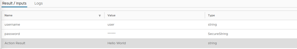

When we run this action, the "Action Result" is a string with value "Hello World".  Note the second line, starting with "Connect-viserver", is commented out.

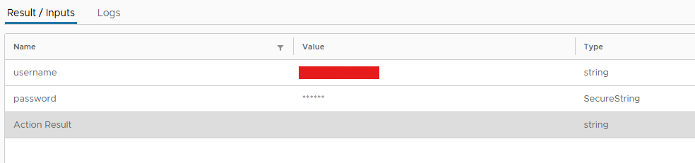

If we remove the comment on the second line of the function, it runs properly. But the "Action Result" is blank.

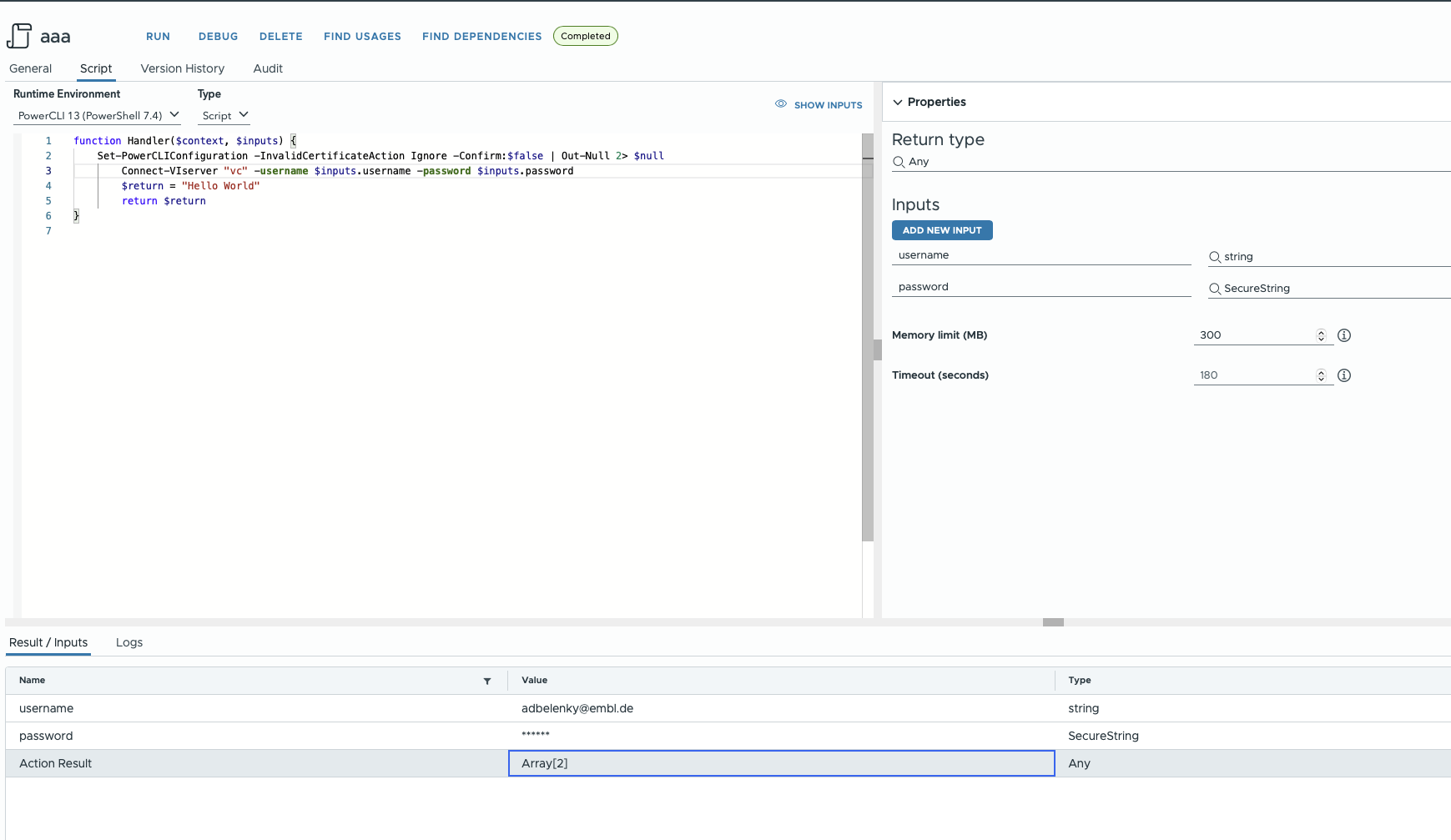

The "problem" is in using `Set-PowerCLIConfiguration`.
If you're using it, it is returning an Array of properties. To see that, set the return type to `Any`. The Action Result will be `Array[2]`.

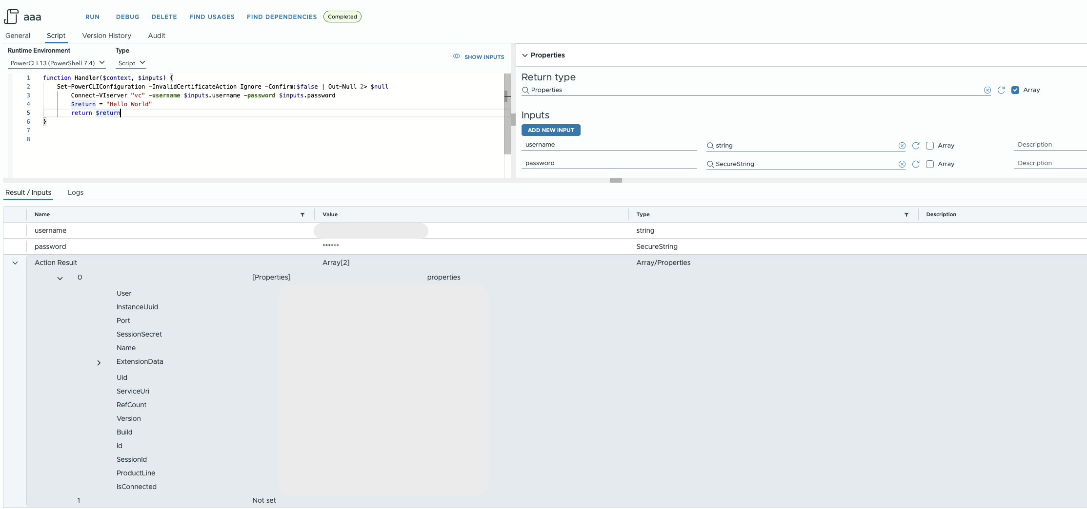

If you'll set the return type to Array/Properties, you will see a lot of information from the vCenter object. But not the actual return value you're expecting to get = "Hello World".

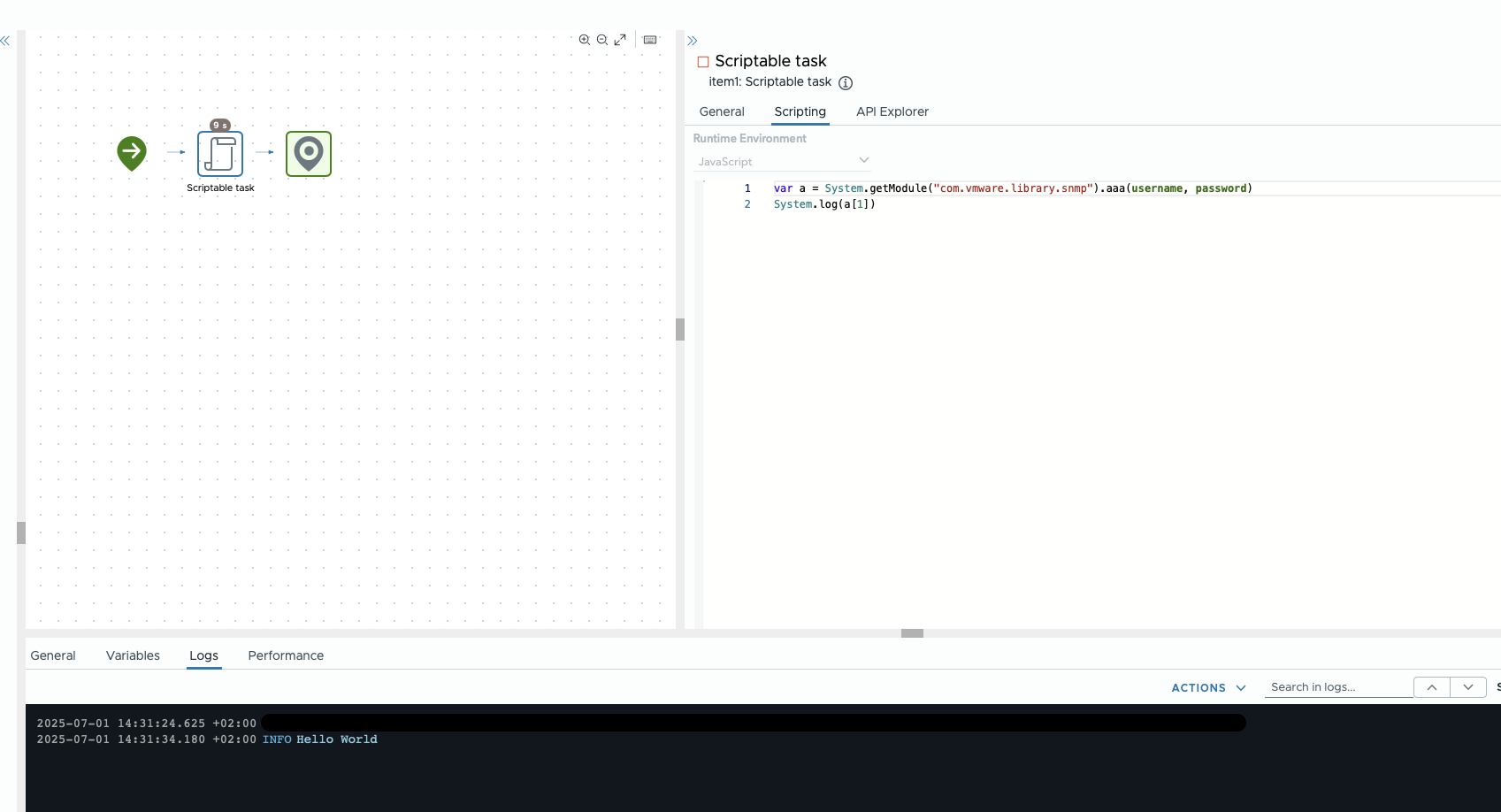

It is possible to see the value of the returned object you want to see. Set the return value of the Action Element to "Any". Create a workflow and use this Action Element in the Scriptable Task. Because it's returning an Array, you can specify [1] and see the result.
