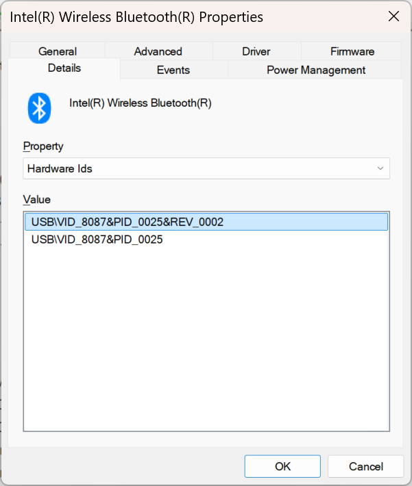

I would like to also share the Intel 9260 bluetooth device with my VM. Device manager shows it as
Ie. 8087:0025 .

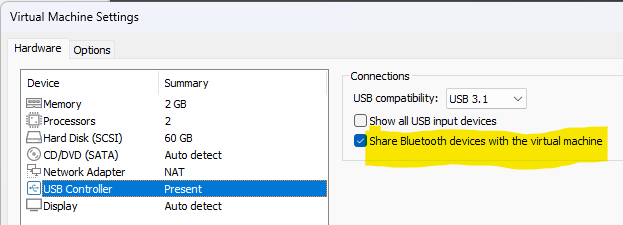

Did you enable this?

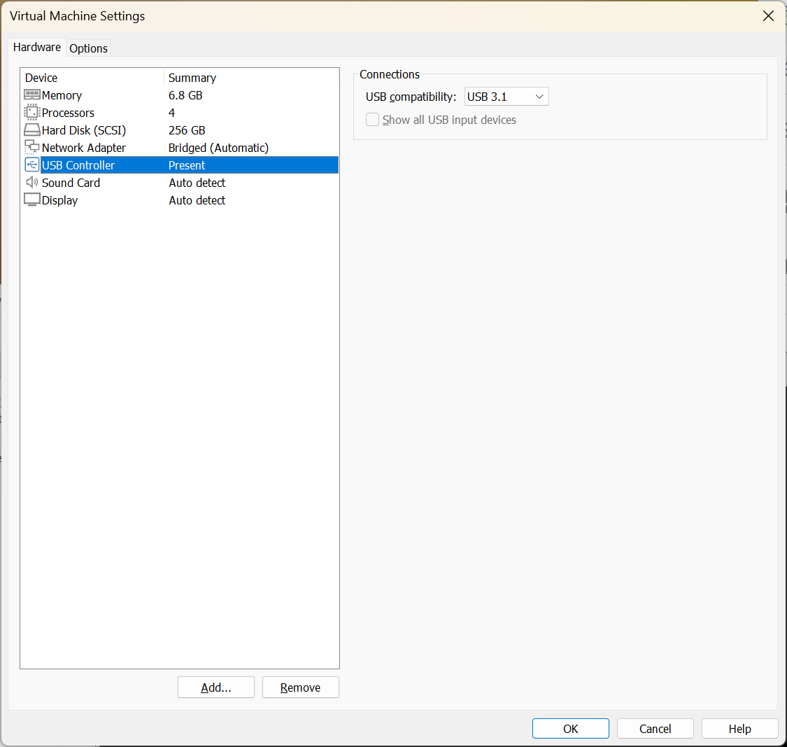

I don't have it on. The bluetooth controller just stopped working completely - as in, it's no longer showing in Windows device manager, or in VMWare workstation, regardless of running it as a service or not. I'm not quite sure if an update to the latest motherboard BIOS broke it, or if it is a hardware failure. Going to try a Linux live USB stick to check if it sees the hardware at all.

And the controller still works in my VM if I start it from the GUI. But it does not show anything about Bluetooth in the USB controller screen.
Despite the absence of this Bluetooth setting, it shows up just fine in my HAOS VM, as long as I start it from the GUI. If I start it from the VMWare autostart service, it doesn't get attached to the VM.
