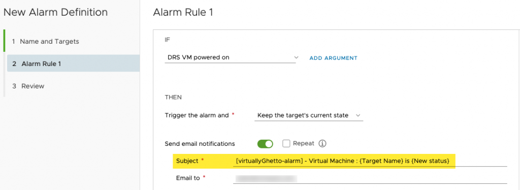

I would like to add the vcenter hostname to the alert subject line and would like to do this with a variable.  I have a powershell script to create the alert actions, but I can not find anything close to what variables are supported on the subject line.  The closet I found was Customizing vCenter Alarm Email Subject and Body
WilliamLam.com remove preview
One of the automated actions that can be configured when a vCenter Server Alarm is triggered is to send an email notification. Over the years, I have seen a number of requests and questions about c...
View this on WilliamLam.com >
However this does not work when I type "{" I do not get the drop down list described.

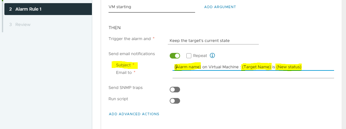

What I am looking for is for the email subject the variable that will give me the vcenter server name
{VariableForHostname} - {Alarm name} on Virtual Machine : {Target Name} is {New status}
The other variable are working as they should and I find lots of references to that format, but I have not been able to find link to the doc to find what others are supported

OK, sorry, didn't realise you were using the New Alarm UI within vCenter. But am I missing something? I created a new host-related alarm with the following subject line:
Alarm {Alarm name} on Host : {Target Name} is {New status}
{Target Name} IS the host name! What happens if you put this variable into your subject line?
I'm assuming that the alarm you are creating has nothing to do with the host and thus the variable may not be available?
JDMils_Interact's profile image
JDMils_Interact
Yeah, looks like the variable is dependent on the initial target you use for the alarm. So I chose an alarm for VMs and got this subject line:
Alarm {Alarm name} on Virtual Machine : {Target Name} is {New status}
Where {Target Name} is the VM now.
