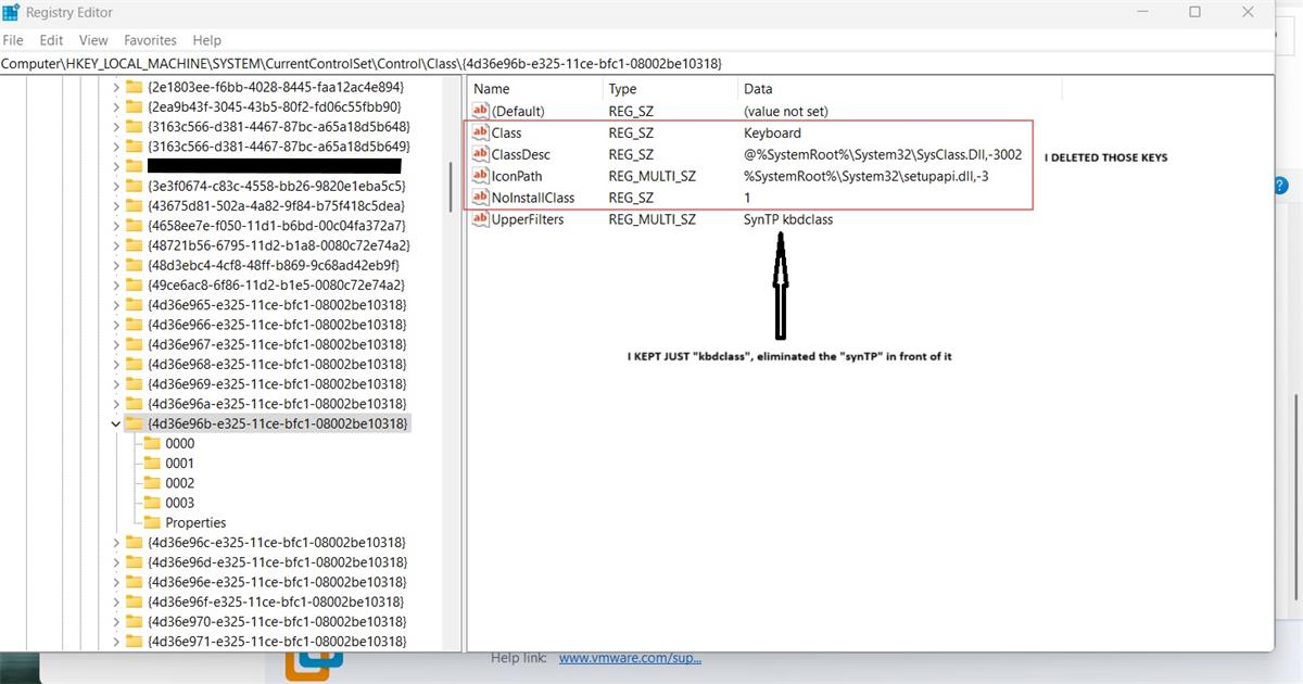

    this is for anyone having the same trouble after upgrading to 17.5.0; I did the standard in place upgrade, and - as allways- installed the enhanced keyboard driver.
    After that I started up my vm and did some work in IDEA. Shortly after I edited some code at once a whole line got erased instead of just 1 click on the remove key. You could literally see the line beeing draged leftwards and dissapear letter by letter.... At first I was ok... well.. wtf... after 2 mins the same again. I rebooted my laptop and restarted my work. Suddenly after 4 mins the whole system removes line by line and this time it even didnt let me use my own keyboard anymore... didnt stop... and tried to delete further even after the code file was already empy (thanks git... no worries here ). Also the whole system hung without beeing able to press any key - only way out was a complete hard reset of the hardware.
    I tried to fix this for some time but only after I did a complete uninstall and reinstall with reboots and lefting out the "enhanced keyboard driver" the problem seems gone.
    So, if you have any problems with your computer typing or deleting on its own: get rid of the "enhanced keyboard driver"!

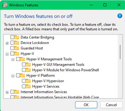

    Hyper-V is enforced (cannot turn it off)

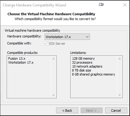

  • 26.  RE: Workstation 17.5.0: (enhanced?) keyboard driver problem
    Posted Oct 30, 2023 09:19 AM
    UPDATE:
    I downgraded from 17.5.0 back to 17.0.2 (old  installers can be found under %APPDATA%/../Local/VMware/)
    Even if you have upgraded your VM with the migration tool to have hardware compatibility with 17.5.x, you can use that exact same tool for downgrading to 17.0.x again.
    If you have a host shared folder(s) mounted, those will be disabled upon upgrading or downgrading, making your VM fail to boot up.
    You can enable your shared folder again in your VM settings in order to fix the bootup.
    Alternatively you can edit /etc/fstab in rescue mode (the line pointing to your shared folder mount point).

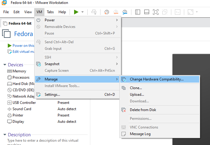

  • 28.  RE: Workstation 17.5.0: (enhanced?) keyboard driver problem
    Posted Oct 31, 2023 02:22 PM
    Ahhh... finally found how to downgrade the VM myself under VM->Manage->Change Hardware Compatibility...
    Downgraded to 17.x and my AlmaLinux 9 VM started successfully again.

    You can downgrade the virtual hardware of the VM.  Then you can uninstall 17.5.0 and reinstall 17.0.2.

    Maybe some extra information.. my enhanced keyboard IS off.. and hyper-v is also not installed. Today it ran fine all morning.. then stopped working in the afternoon. When it freezes, num-lock is not responding anymore either. The key cursor is still blinking.
    In an attempt to figure out what parameters are influencing the freezing, I will enable the enhanced keyboard in the VM, since I did install it after doing a clean VM ware workstation 7.5.0 install but left it disabeld in the VM. Just note that it was also freezing when the enhanced keyboard driver wasn't even installed with VM ware.

    When people say "Hyper-V is not installed" I never know what they mean or if they are aware on how this works.
    You don't need to install Hyper-V in order for VMware Workstation to use the Windows Hyper-V API's.
    Check the vmware.log file of your VM for the words "monitor mode".
    If it says "ULM" then you are using the Hyper-V API's. Only when it says "CPL0" you are using VMware's hypervisor.
    Wil

    Yeah, fair point. I meant that all the boxes next to Hyper-V are unchecked in the "Turn windows features on or off" dialog.
  • 56.  RE: Workstation 17.5.0: (enhanced?) keyboard driver problem
    Posted Oct 30, 2023 04:38 PM
    that's clear. You're using VMware's hypervisor, I guess that excludes finger pointing to Microsofts hypervisor for this issue.
    sadly that still doesn't mean you're using VMware's hypervisor, I wish it was that clear cut.

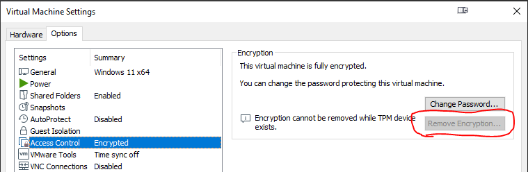

    I worked around my issues by reverting VM ware workstation back to 17.0.0. Since I already spent so much time trying to analyse this problem I figured I might as well add a little guide on how to roll back your version.
    During my 17.5.0 installation I let it upgrade my encryption to the latest standards, so when I tried to downgrade, I had to remove the encryption first. You can do that by editing your virtual machine settings:
    And then press Remove Encryption. This exampled shows a grayed out button, because this is a screenshot from a Windows machine, but it was enabled for my Fedora VM:
    Then revert the VM compatibility to VM Workstation 17.x
    Change it here:
    And now just use the "Add and remove programs" from windows to start the VM Workstation uninstaller. After that you may want to reboot and install 17.0.0. Hopefully the VM ware team will come with a patch to fix the issues.

    Reverting to 17.x compatibility the result is the same ...
    Opened a text editor, used down arrow, moved mouse out of the guest window and keyboard and mouse hang.

    after removing the enhanced keyboard driver, removing all hyper-v and trying various tweaks I now revert back to 17.0.0 (.1 and .2 wont work as well as network wont work ... was fixed in 17.5... that wont work without this crap here )
    Really dont know how this could have passed VMWare testing

    I made a backup of my VM and upgraded to 17.5.1. I skipped the encryption and HW compatibility upgrades for now and will make sure that everything keeps working before I'll upgrade those :). Hopefully this case is now closed!

    Hi, I finally got it to work with V17.5.
    HOW I FIXED THE KEYBOARD ISSUE IN VMWARE V17.5
