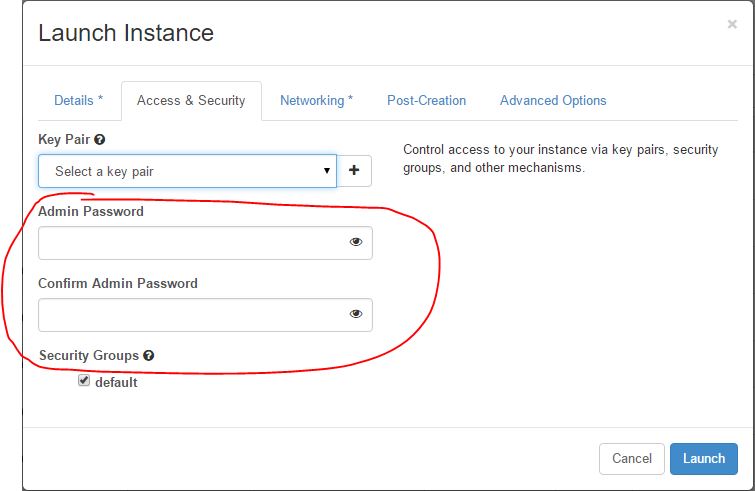

    I ran the same as above, but didn't allow cloudbase-init to sysprep the Windows VM, and found that VIO 2.0 wasn't pushing my specified Administrator Password in:
    I also am not seeing the options to specify affinity rules. Any help on any of this would be great.

    You're not alone, I'm struggling with this too. If I install cloudbase-init with sysprep it gets stuck in the same reboot error cycle. If I don't sysprep I can't even get it to set an IP or run any of the cloudbase-init post scripts. That being said, if I wait long enough (5+ minutes) it will reboot the guest and set my password that I enter into the launch instance window. I'm still playing around with it though, I will let you know if I figure something out.
