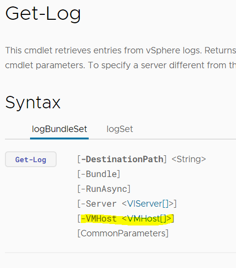

    I see. And I recognize that the description says a vCenter Server. However, the very Get-Log documentation you shared in your first response appears to show that VMHost is a valid parameter of that set.
    I'm not trying to be difficult. I just swear that this used to work - and the Help example and the parameterset documentation seem to reaffirm my memory. And I tend to exhaust trying the more straightforward approach before I adopt more complicated alternatives.
