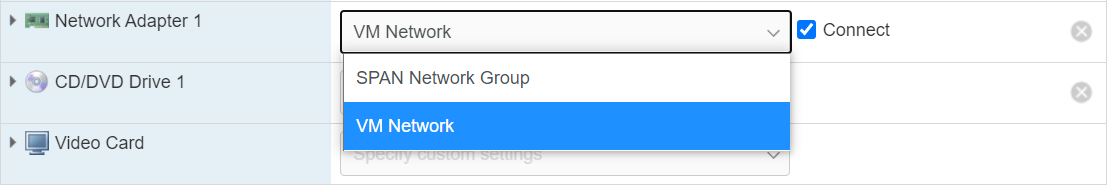

    I've currently got 2 vswitches working in my environment for connectivity to seperate LANs.  I'd like to create a 3rd/4th.  I've configured the vswitch, same as the original 2; however, when I go to edit the settings on a VM and click the down arrow to choose a network adapter, I am NOT seeing the 3rd/4th vswitch.  A friend helped me setup the original vswitch, so its entirely possible I've missed a step, but am curious why I don't see the new vswitch listed in network adapters?
    I get the same 2 original vswitches ONLY.  I've tried mutliple vm's but no dice, they all look the same, so I'm thinking it has to do with my vswitch configuration (but only a guess)?

    Did you create a VM Port Group on the new vSwitch? (you assign the network adapter of a VM to a VM Port Group, not to the vSwitch)

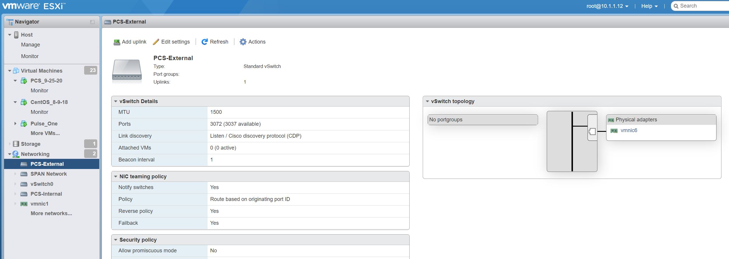

    This is all inside one ESXi host, yes.  Perhaps I should state my end goal also?
    I have a 4 port nic in this server.  I want to use 2 physical ports (one in and one out) for a given VM.These NICs would be dedicated to this single VM.
    I realize this isn't probably the most appropriate use of vm resources, but none-the-less what I'm trying to configure>  a DMZ gateway of sorts
    here are my screenshots

    You've created a vSwitch with no port groups. VMs do not attach to vSwitches, they attach to port groups. You must create one designed for VMs for them to show in that list.

    Exactly as I mentioned, you connect the network adapter of a VM to a VM Port Group - but your vSwitch doesn't have any VM Port Groups, where the bottom screenshot says "No portgroups"
