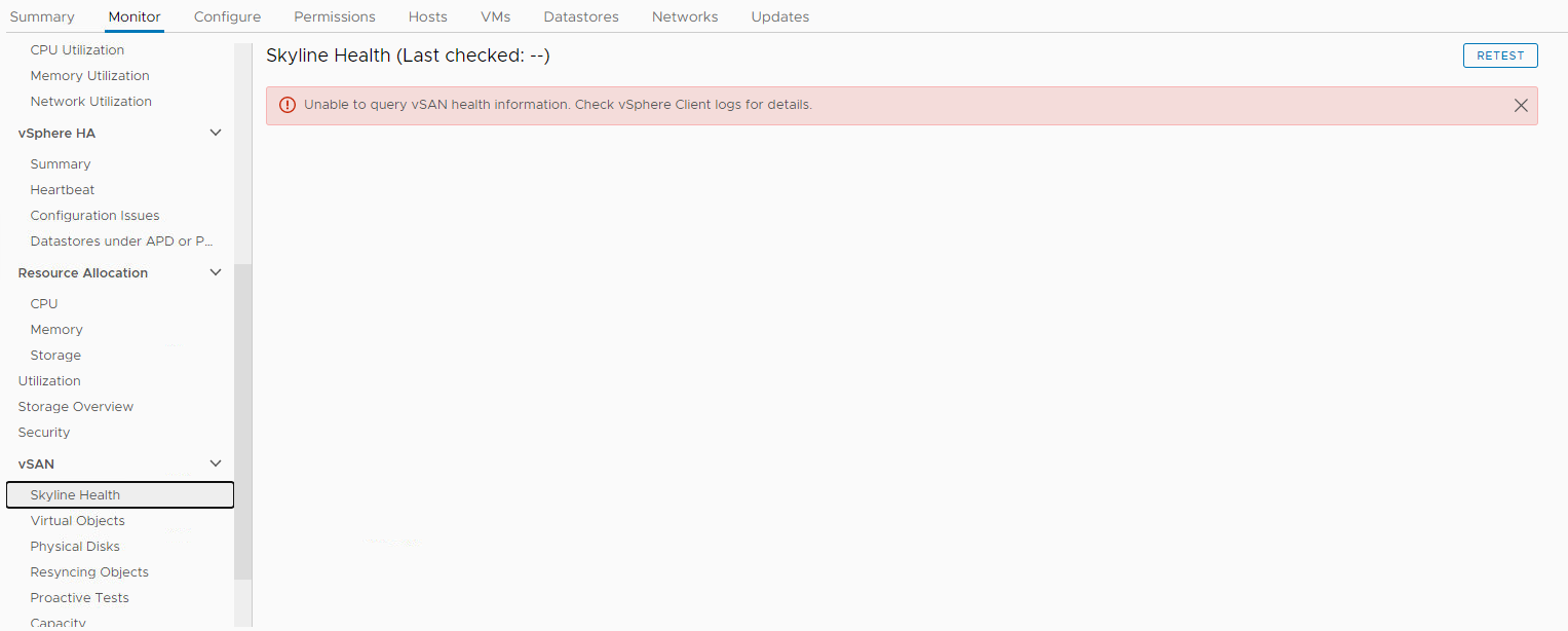

    When checking the "Monitor>vSAN>Skyline Health" option, I'm getting this error: "Unable to query vSAN health information. Check vSphere Client logs for details."
    I'm running VCSA 7.0.0.10300 and everything worked decently fine up until recently.
    This error seemingly happened after I rebooted VCSA, and has now left me unable to access all my vSAN monitoring tools. I've tried looking into the logs but I have no idea what I'm looking for. Restarting the vmware-vsan-health and vmware-analytics services didn't seem to fix the issue either, and rebooting VCSA leaves me with the same error.
    I've been told it has something to do with a "certificate issue (thumbprint mismatch)", but I need a "special script"(?) to fix it. Does anyone happen to have a possible solution?

    Hello Smugsy​,
    Welcome to Communities.
    Is this a fresh install of vSphere 7.0 or upgraded from previous versions?
    Can you confirm if other vSAN-related aspects in the UI are impacted?(e.g. Cluster > Configure > vSAN > Disk Management & Cluster > Monitor > Capacity)
    There are 2 main potential issues that could be the cause:
    - One relating to SSL trust anchors with some good info posted here:
    https://www.reddit.com/r/vmware/comments/e4w74j/vsphere_67_u3a_vsan_html5_failed_to_extract/
    - Another due to mis-conversion of character case in a required string (I cannot recall off the top of my head what the string was used for but similar issue could occur as a result).
    I would start with checking the SSL aspect first, but either way I would advise opening a case with vSAN GSS as there are other potential causes.

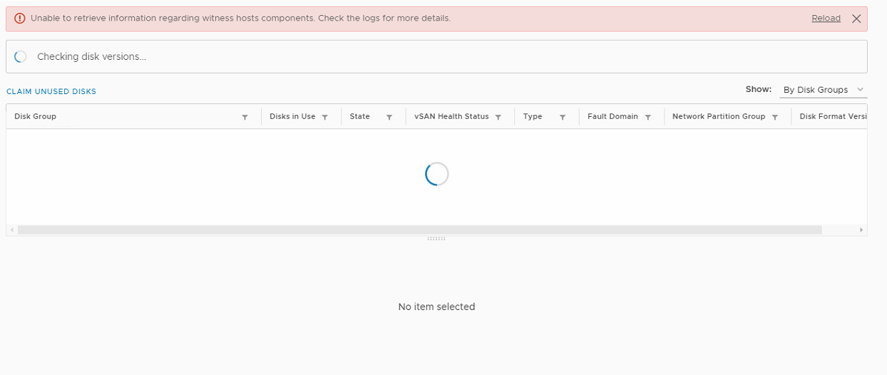

    This is a fresh install of the available evaluation version of vCenter 7 together with four vSphere 7 hosts that has joined the SSO domain, which are all in the same cluster right now.
    Yes, every part of vSAN is currently affected by this issue. I cannot do any vSAN configuration or monitoring via the vCenter webgui.
