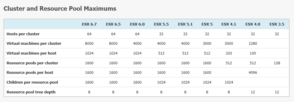

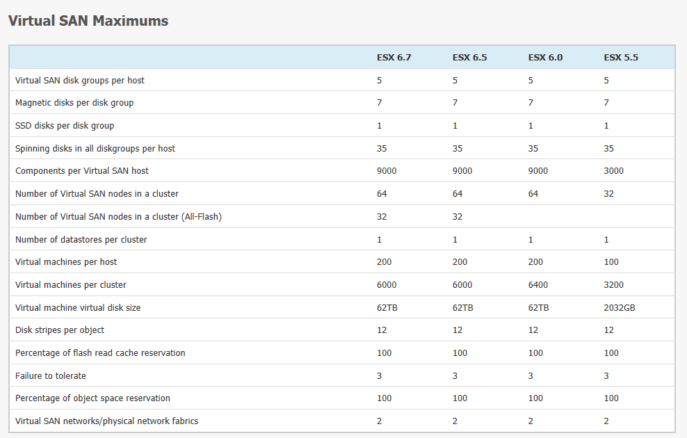

    "It's Possible."
    Alessandro, that is incorrect information and I also have no idea why you posted images and links to completely unrelated information.
