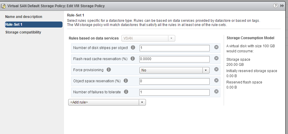

    Do i need to change the vSAN storage policy so it doesn't require 3 fault domain, if so where, as i have already removed the line 'Number of failures to tolerate' but i still receive the same error.
    Thanks

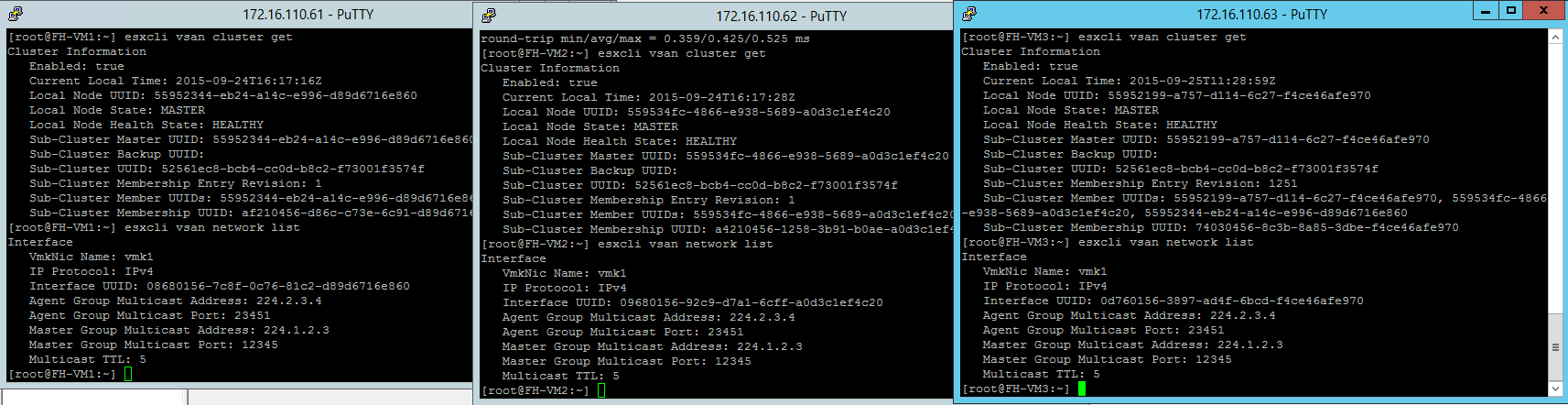

    I have also checked the MultiCast network settings and have the below:
    Do these settings seem ok?
    Thanks

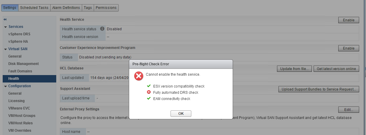

    So after overcoming the Plug-In installation by installing via local administrator, i now have the below:
    So...... i cannot enable DRS as i only have Essentials Plus Licenses?! Any way around this or any other method to check the health of vSAN?
    Not going well at the moment :smileysad:
    Thanks

    ‌Download the VIB and install it manually on each of the hosts in the cluster. The link to the VIB is in the health check guide.
    Keep persevering. The health check should reveal why you cannot deploy your VMs. I suspect the cluster is partitioned. The health check will tell you why.

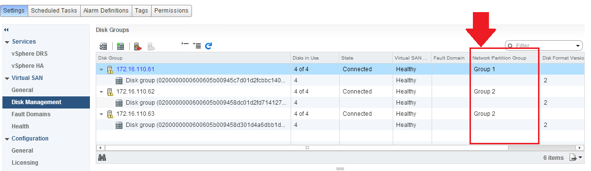

    I have a suspicion that it is to do the Network Partition Groups as i believe that they should be the same?
    Is someone able to confirm this? If true, how do i overcome this?

    And yes - that partition is your problem.  You need to figure out why host 61 is not communicating correctly to host 62 and 63 over the VSAN network.
    If you don't install the health check, use the networking section of the VSAN troubleshooting guide to figure it out. Remember, multicast is a requirement, so if you have IGMP, make sure its working properly. This is usually the problem.
