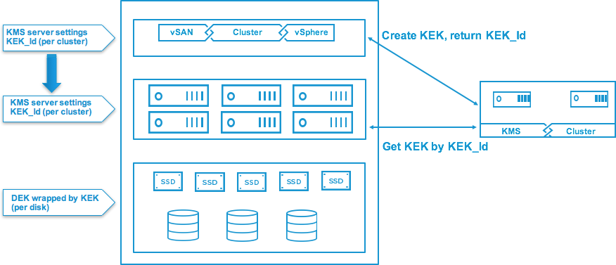

    You are correct. So if you backup from your PROD vSAN encrypted cluster, you can still restore the VMs to your DR site running on other storage or a different vSAN cluster.
    As far as the DEK, this key is not associated to a VM in vSAN Encryption, but to a disk in vSAN instead. Each disk in the cluster has a unique DEK. The KEK from KMS is used to encrypt the DEK.
