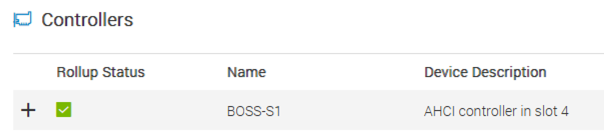

     - Boss card is installed but think it came pre-configured as one virtual disk using all space (Raid1) and this is where ESXi is installed.
    So looks like ESXi would need to be wiped and existing virtual disk removed to create two instead (and ESXi re-installed)

    1. With BOSS-S1 it is possible to partition the RAID1 to get two VDs. The first one i sized with 128GB for ESX_BOOT and the second with the rest of the space which is ESX_DATASTORE
    2. With a BOSS-2 it is not supported to create partitions on
    3. With Dell 14Gen the VMFS6 partition are DISABLED by default when using the Dell Custom ISO. There was a rescent thread about this in the VMTN. The linked to a Dell KB
    4. With BOSS-2 and Dell 15.Gen Poweredge i have no trouble to use the rest of the one and only VD on the BOSS-2 as a additional VMFS6 datastore

     - Its BOSS-S1 so possible to delete and create 2x virtual disks as per your comment.
    But in any case this will require the deletion of existing ESXi which is not ideal, so something that should be done first thing prior ESXi install.
    Actually these are vSAN Ready Nodes so came with ESXi pre-installed now that I remember.
    I wonder why these do not come pre-partitioned into 2x virtual disks knowing the vSAN requires a VMFS datastore?
    Bottom line, adding a VMFS datastore via the BOSS Card might be possible but not straightforward in this case.
