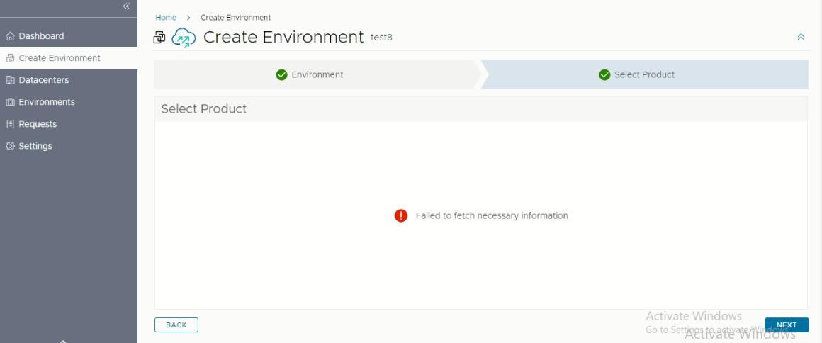

    when I try to create an environment inside VRSLCM that is integrated with SDDC manager , it fails to fetch products and show error " failed to fetch necessary information
    I changed VRSLCM certificate with authorized one , uploaded support pack 17 and applied it but nothing changed
    I investigated Logs in VRSLCM
    in vmware_vrlcm.log file I found that the error occurs every time when trying to fetch "cloud proxy" products
    example:
    2023-11-11 00:22:30.674 INFO [every-boot-thread] c.v.v.l.c.c.ContentDownloadController - -- INSIDE isContentExists
    2023-11-11 00:22:30.674 INFO [every-boot-thread] c.v.v.l.c.c.ContentDownloadController - -- URL :: /productSpecRepo/cloudproxy/1.0.0/sizingInfo.json
    2023-11-11 00:22:30.705 WARN [every-boot-thread] c.v.v.l.c.s.ContentDownloadUrlServiceImpl - -- contentDownloadUrl is not present with given URL ::/productSpecRepo/cloudproxy/1.0.0/sizingInfo.json
    2023-11-11 00:22:30.707 INFO [every-boot-thread] c.v.v.l.c.c.ContentDownloadController - -- URL :: /productSpecRepo/cloudproxy/1.0.0/sizingInfo.json not exists.
    2023-11-11 00:22:30.708 ERROR [every-boot-thread] c.v.v.l.l.s.ProductPolicyServiceImpl - -- policy path does not exist: /productSpecRepo/cloudproxy/1.0.0/sizingInfo.json
    2023-11-11 00:22:30.709 INFO [every-boot-thread] c.v.v.l.c.u.StringUtil - -- QUERYING CONTENT :: ProductPolicy::products->vropscloudproxy::productVersion
    2023-11-11 00:22:30.710 INFO [every-boot-thread] c.v.v.l.d.i.u.InventorySchemaQueryUtil - -- GETTING ROOT NODE FOR :: ProductPolicy
    Logs file is attached

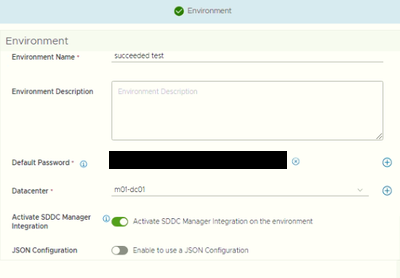

    May be it's not clear in the subject
    If I create a non-integrated environment with vcf ( like the steps in the video ), it succeeds without any problem
    But if i select the option " Activate SDDC manager integration on the environment " while creating the environmet,  it fails and gives this error " failed to fetch necessary information " !
    And this error before it asks me about any certificate

    finally the problem is solved !!
    first , I found that the step of fetching products taking much time before it releases the error " failed to fetch necessary information "
    then I discovered the nginx error.log file in vrealize life cycle manager vm
    ssh to vrlcm vm with root account hen run this code
     tail -f /var/log/nginx/error.log
    and I found this line repeated many times
    2024/01/31 09:49:52 [error] 25657#0: *28 upstream timed out (110: Connection timed out) while reading response header from upstream, client: 172.16.11.1, server: vrlcm.ssc.local, request: "GET /lcm/lcops/api/policy/products?includeAllProducts=true&vcfEnabledEnvironment=true HTTP/1.1", upstream: "http://127.0.0.1:8080/lcm/lcops/api/policy/products?includeAllProducts=true&vcfEnabledEnvironment=true", host: "vrlcm.ssc.local", referrer: "https://vrlcm.ssc.local/lcm/lcops/environment-workflow/globalenvironment"
    that made me to check nginx.conf to figure proxy time out
     vi /etc/nginx/nginx.conf
    and I found this configuration in products policy
    location /lcm/lcops/api/policy/products {
    limit_req zone=mylimit burst=20 nodelay;
    proxy_pass http://vrlcm-server;
    proxy_read_timeout 2m;
    proxy_send_timeout 2m;
    so i edited them from 2m to 10m
    proxy_read_timeout 10m;
    proxy_send_timeout 10m;
    and now fetching products with option "Activate SDDC Manager Integration on the environment" works successfully
