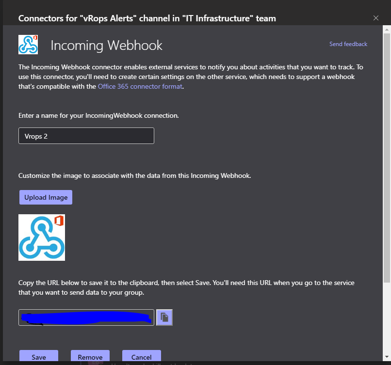

    So on Ms Teams we have set-up the incoming webhook. It then gives you a url for you to send the webhook to.
    This i what i get when i browse to the url.

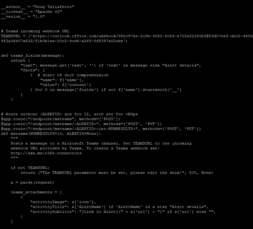

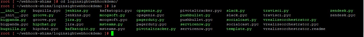

    This is the files that are inside the folder. The __init__.py does have the import loginsightwebhookdemo.msteams in is and here is the msteams.py file
    The URL goes on and on but didnt want to make the picture massive and unreadble. I have tired it without the brackets but it makes no difference either way
