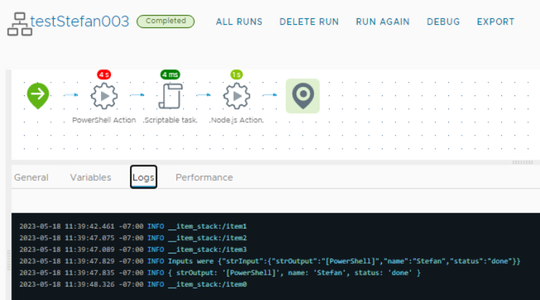

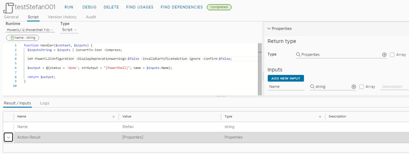

    The output type is Properties and the Set-PowerCLIConfiguration is disabled. In the Action result we see all values.
    After enabling the Set-PowerCLIConfiguration I got no ActionResult.

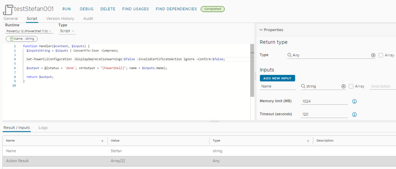

    So I changed the Return type to Any and here I get a result, an array with two entries:

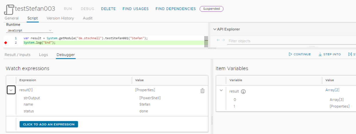

    Hmm, now I tried this:
    var result = System.getModule("de.stschnell").testStefan001("Stefan");
    System.log(result.constructor.name);
    If Set-PowerCLIConfiguration is disabled the return type is Object, if it is enabled it is Array.
    It seems that the return variable type changes with the Set-PowerCLIConfiguration command. Weird.
    If you use Set-PowerCLIConfiguration command you can find the properties in the array.
    Otherwise it is direct in the action result.

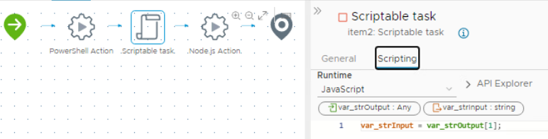

    One workaround to handle this is to add a scriptable task in the workflow and to set a variable to strOutput[1].
    On this way you can then pass it to the Node.js action, as you can see here.
