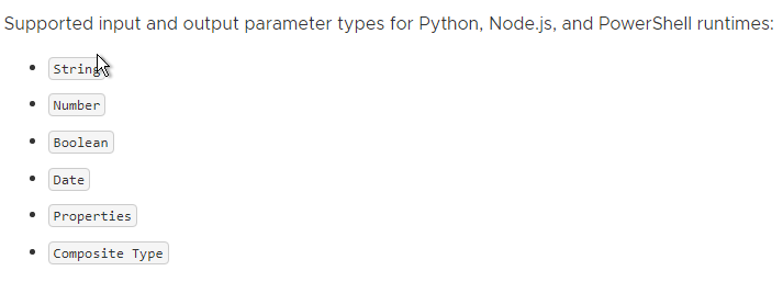

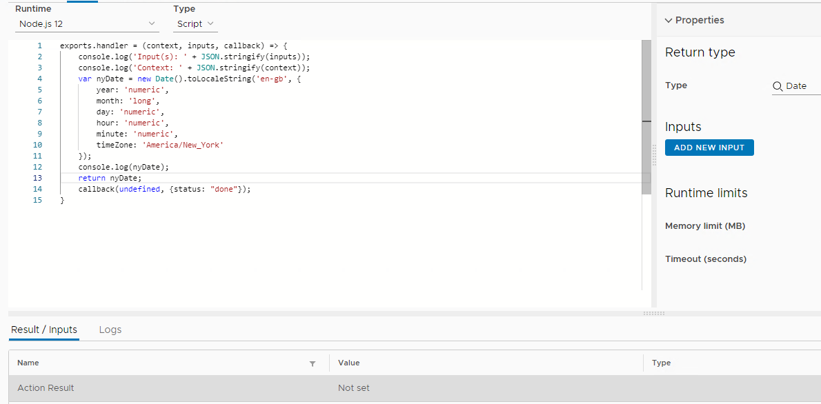

    So, even though the Date is one of the supported return types by a Node.js script in vRO,
    It doesn't seem to work.

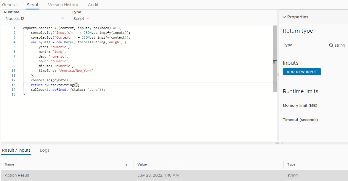

    However, we can use toString() and set the return type to String. this worked for me.
    exports.handler = (context, inputs, callback) => {
        console.log('Input(s): ' + JSON.stringify(inputs));
        console.log('Context: ' + JSON.stringify(context));
        var nyDate = new Date().toLocaleString('en-gb', {
            year: 'numeric',
            month: 'long',
            day: 'numeric',
            hour: 'numeric',
            minute: 'numeric',
            timeZone: 'America/New_York'
        console.log(nyDate);
        return nyDate.toString();
        callback(undefined, {status: "done"});

    So based on what I see from your screenshot it looks like you are showing the view from Cloud Assembly | Extensibility | Actions.
    Where as I am referring to VRO. I did try what you suggested but still no luck.
    UPDATE: So I took the code I had in the scriptable task and moved it into an action. Then took that action and added it as a workflow element and then things worked.
