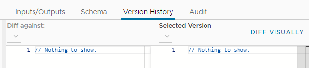

    Using .gitignore seemed to do the trick but when the repo is pulled, .gitignore file also added to vRO. This resulted in losing version control on ignored objects (in my case I ignored certain workflow folders).
    So ignoring resulted not only in preventing syncing but preventing versioning locally...
  • 9.  RE: vRO git repo exclude configuration elements and resource elements. Is this possible?
    Broadcom Employee
    Posted Mar 24, 2022 05:47 PM
    Does it prevent you from just bumping the version manually on the workflow and using "Save" button vs. using "Version" button?
  • 10.  RE: vRO git repo exclude configuration elements and resource elements. Is this possible?
    Posted Mar 25, 2022 08:11 AM
    I can increase / save  version manually, but version history is empty:
  • 11.  RE: vRO git repo exclude configuration elements and resource elements. Is this possible?
    Broadcom Employee
    Posted Mar 25, 2022 01:41 PM
    Oh. that is a bummer! I'm out of ideas here.
