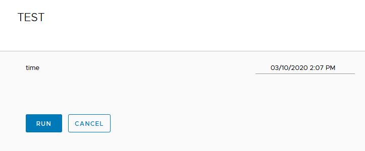

    I test with a tiny workflow to check the date/time:
    Input:
    so far so good. 03/10/2020 2:07 PM

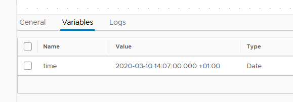

    Variables in the workflow run:
    still okay, seems to be CET ;D

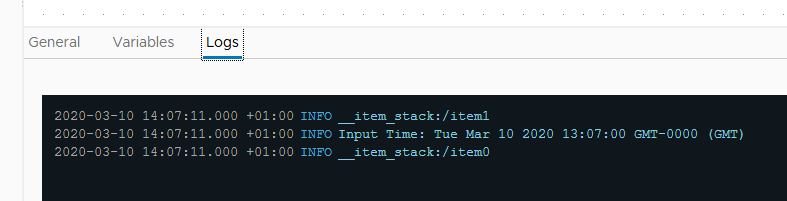

    Logs:
    System.log("Input Time: " + time);
    Time is now in GMT?!
    Do you have any idea whats going wrong here?

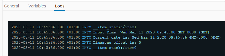

  • 3.  RE: vRO 8.0.1 - Type "Date" in GMT instead of CET (as configured)
    Posted Mar 11, 2020 10:06 AM
    Hi,
    output looks that way....
    no offset at all. :smileysad:

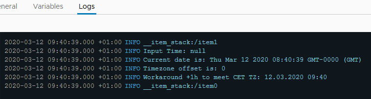

  • 4.  RE: vRO 8.0.1 - Type "Date" in GMT instead of CET (as configured)
    Posted Mar 12, 2020 08:48 AM
    Just added a dirty workaround ;D
    var d = new Date();
    System.log("Current date is: " + d);
    System.log("Timezone offset is: " + d.getTimezoneOffset());
    d.setHours(d.getHours() + 1)
    System.log("Workaround +1h to meet CET TZ: " + System.formatDate(d,"dd.MM.yyyy HH:mm"))
    Works until the daylight saving time change....
    here the output:
    iiliev​ Do you think that this is a misconfiguration that I can fix in any way, or may it be a bug?
    kind regards ^.^
