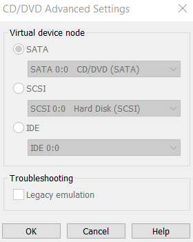

    Got the same issue. Looking at the log file, I see thousands of entries like these:
    2023-09-29T13:09:15.244Z In(05) vcpu-0 VIDE: (0x170) Unexpected IN for cmd 0xa3 len 2
    Does anyone else also have these entries?
  • 22.  RE: VMware® Workstation 17 Pro, Linux VMs keyboard lag
    Posted Oct 05, 2023 07:34 AM
    Was able to fix this, seems to be related to this: https://bbs.archlinux.org/viewtopic.php?id=288723
    My workaround: check SATA instead of IDE in CD/DVD > Advanced
  • 23.  RE: VMware® Workstation 17 Pro, Linux VMs keyboard lag
    Posted Oct 05, 2023 03:13 PM
      Amazing. I just removed the CD/DVD device from the VM and the stuttering has disappeared.
  • 24.  RE: VMware® Workstation 17 Pro, Linux VMs keyboard lag
    Posted Jan 23, 2024 03:38 PM
    Disconnecting the SATA CD drives worked for me too! Thanks!
  • 25.  RE: VMware® Workstation 17 Pro, Linux VMs keyboard lag
    Posted Apr 04, 2024 09:24 AM
    i9 13thgen - windows 11 23h2 - vmware workstation 17.5.1 build-23298084
    same laggy keyboard problem on VM (rocky linux 9.3)
    disable CD/DVD Device also did the trick for me
    no laggy keyboard anymore
    thanks
  • 26.  RE: VMware® Workstation 17 Pro, Linux VMs keyboard lag
    Posted Oct 09, 2023 02:33 AM
    Likely related to a recent kernel bug involving the scsi driver's behavior with the VMware IDE CDROM device 20230915022034.678121-1-dlemoal@kernel.org/" target="_blank" rel="noopener">https://lore.kernel.org/linux-scsi/20230915022034.678121-1-dlemoal@kernel.org/
    Valid solutions I’ve confirmed:
    1. Shutting down and X’ing the CDROM drive in VMware before starting the guest up again
