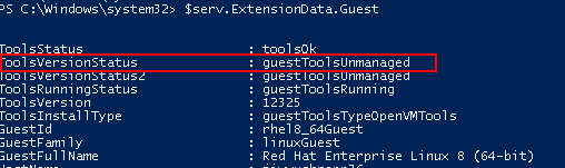

    Not sure what the problem is, the ToolsVersionnStatus and ToolsVersionStatus2 are from the point of view of VMware Tools.
    The ToolsInstallType clearly says that the Open VMware Tools are installed.

    As I said earlier, those ToolsVersionStatus and ToolsVersionStatus2 properties are only useful when you have VMware Tools installed.
    You will first have to check ToolsInstallType, then select the correct properties.
