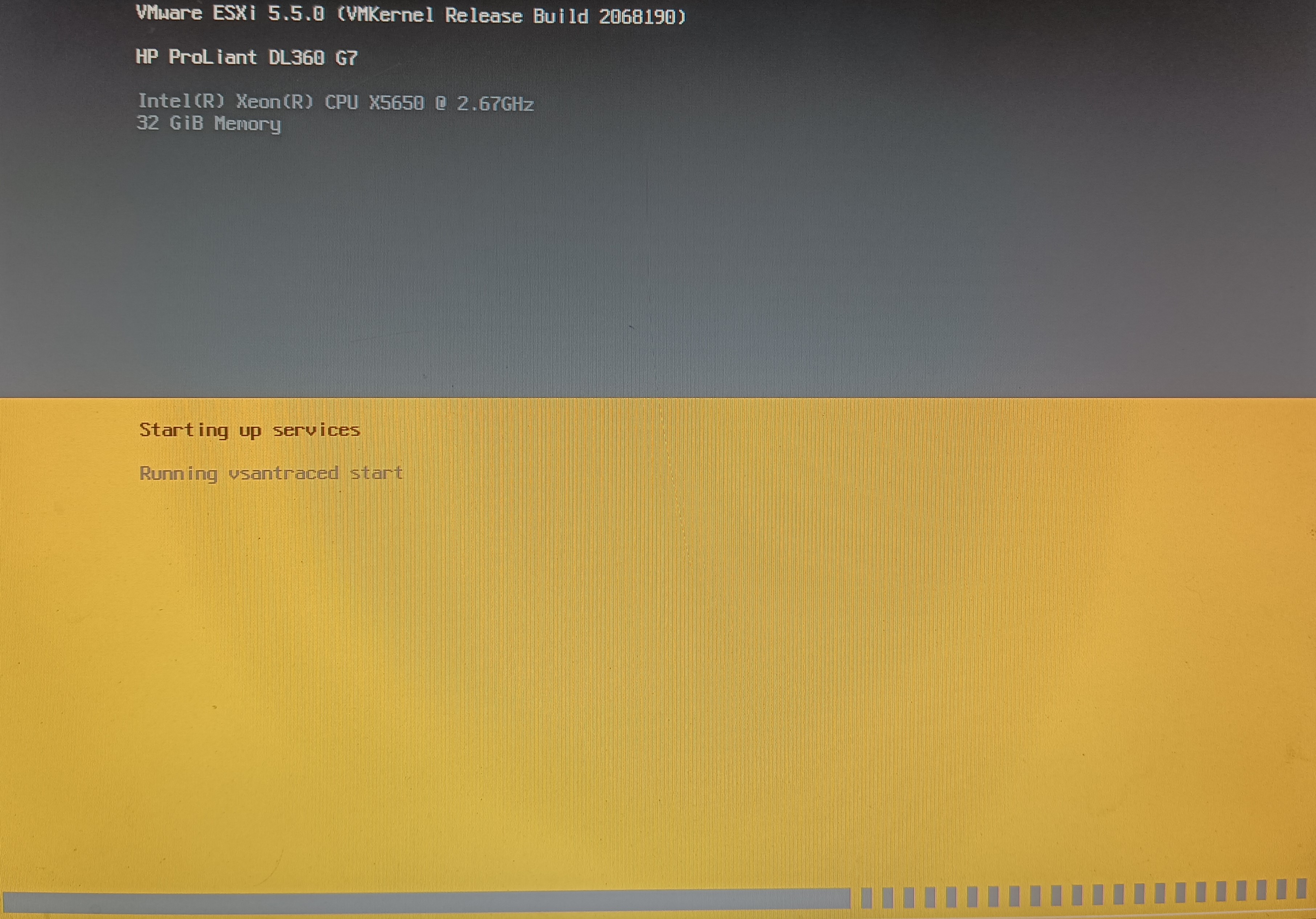

    My ESXi 5.5.0 hung for more than 1 hour when booting. It hanged on "Starting up Services" "Running vsantraced start":

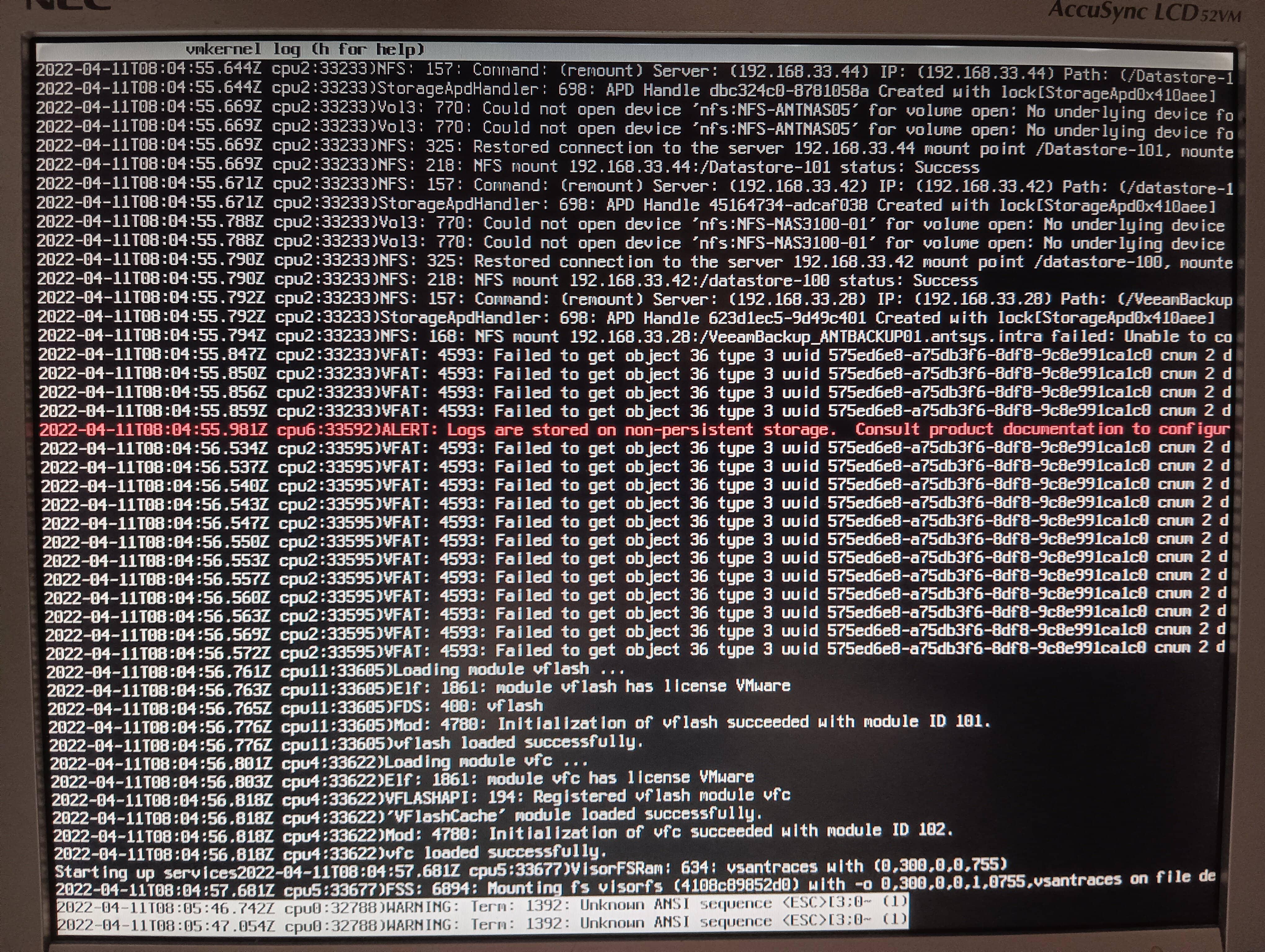

    When I press alt+F1 I see this:

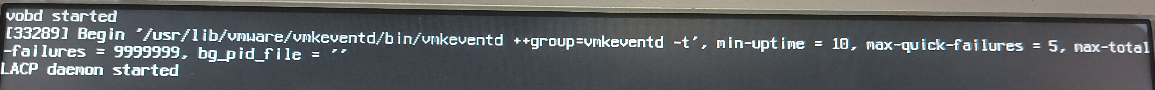

    When I navigate into the Alt+? I also see this :

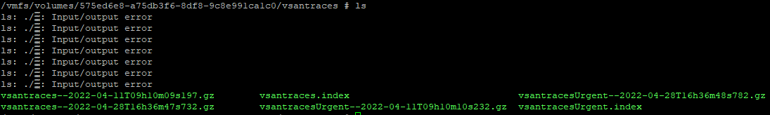

    But at
    /locker/vsantraces/
     I see this with a simple "ls" :
    I'm aware that display is not normal/conventional.
    Regards.
