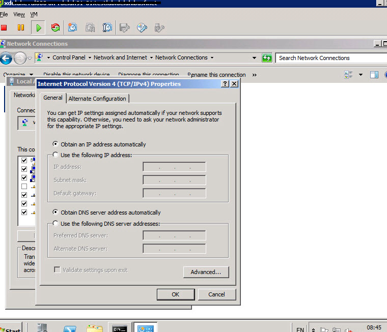

    i'm currently testing vSphere replication and based on all tests i have done all recovered VMs do not have IPs configured.
    I checked the admin guide PDF and this is mentioned anywhere.
    Is it normal ? do i have to re-ip my VMs all the time once recovered ?

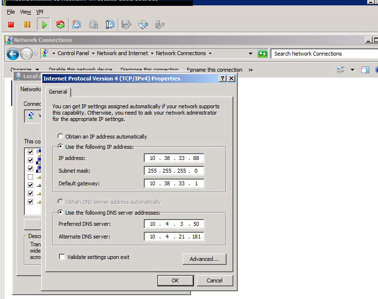

    i've been installing VR for customers since v5.0 and never seen this. can you screenshot the TCPIP properties before the VM is recovered and after you've recovered it? what windows version is this inside the GuestOS. Something doesn't sound right here.
  • 13.  RE: VMs replicated without IP
    Posted Sep 27, 2013 06:58 AM
    Hi,
    thanks for your reply, it sounds a bit weird i have to post screenshoots but there you are (after migration , before migration).
