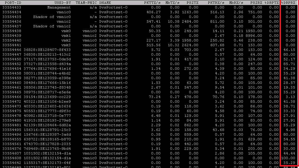

    When i try vmkping, no packet drops but i saw DRPRX is showing values in esxtop.
    is this unusual or usual?

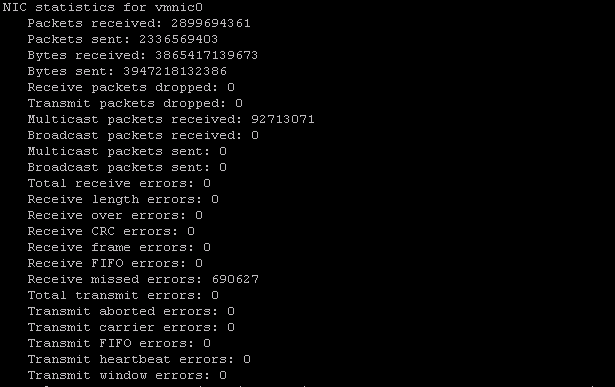

    When i ran esxcli network nic stats -n vmnic0, i am seeing receive missed errors. Is this usual or unusual?
