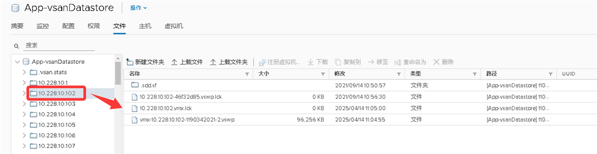

    环境:VMware vShpere vsan6.7
    现象:对正常在用的虚拟机编辑,新添加一块磁盘时,确定后任务进度卡在百分之十几不动,直至添加失败出错"与远程主机通信时出错",然后该虚拟机大小就变成只有几十兆大小了,导航至vsan后端到该虚拟机目录查看,发现所有的vmdk文件都没有了,已经出现好几次这种问题了,是否有解决方案

    From your screenshot, the vmdk descriptors and also the .vmx appear to be gone - you should check the shell.log (on all hosts) and hostd.log to check whether someone/something is deleting these, that is not normal and not something vSphere/ESXi/vSAN would do under any circumstances.
    It is also possible that deletion of these occurred some time in the past and only when you go to make some other change that triggers update/refresh of these files (and/or release of locks e.g. power-off of VM) that deletion of these is able to complete.
