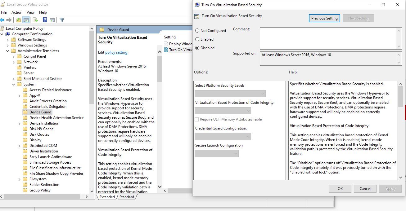

  • 4.  RE: Virtualized AMD-V/RVI is not supported on this platform.
    Posted Jun 03, 2022 08:41 PM
    I found something new that worked for me.
    After confirming that my BIOS processor virtualization setup was correctly enabled and tried "bcdedit /set hypervisorlaunchtype off" without effect in my machine, I found another info that solved my problem here.
    "Disable Turn on virtualization Based Security"
    Go to Local Group Policy Editor > Computer Configuration > Administrative Templates > System > Device Gaurd
    Disable Turn On Virtualization Based Security.

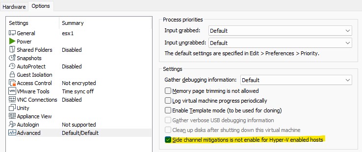

  • 18.  RE: Virtualized AMD-V/RVI is not supported on this platform.
    Posted Mar 07, 2023 01:19 PM
    Disabling Side channel mitigations for Hyper-V enabled hosts worked for me.
    VM Settings -> Options -> Advanced
    My System: Workstation 17 Pro on Windows 11 Pro with WSL on Ryzen 7 Pro.

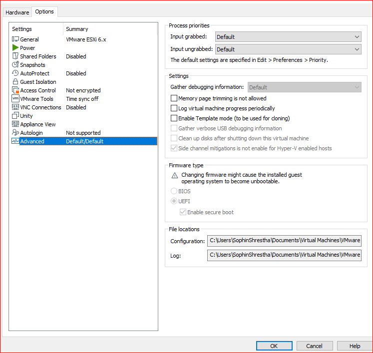

  • 19.  RE: Virtualized AMD-V/RVI is not supported on this platform.
    Posted Jul 26, 2023 06:06 AM
    Enabling Side channel mitigation and Enabling Secure boot under UEFI worked for me.

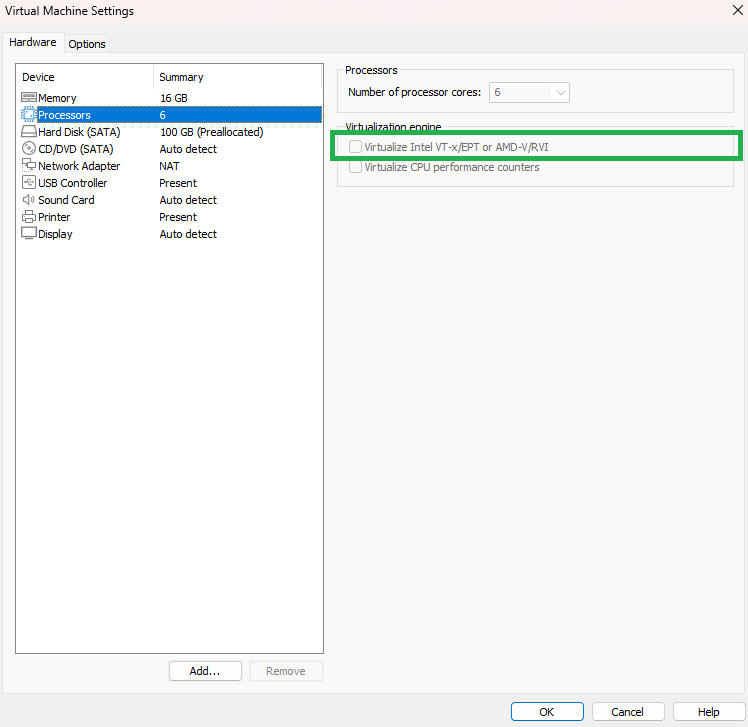

  • 21.  RE: Virtualized AMD-V/RVI is not supported on this platform.
    Posted Aug 25, 2023 02:33 PM
    I had the same issue, my vm player was running ok, but, suddenly it wasn't. So it happened me before, then I remembered it, so, I left the picture about it. Just unselect the green box.
