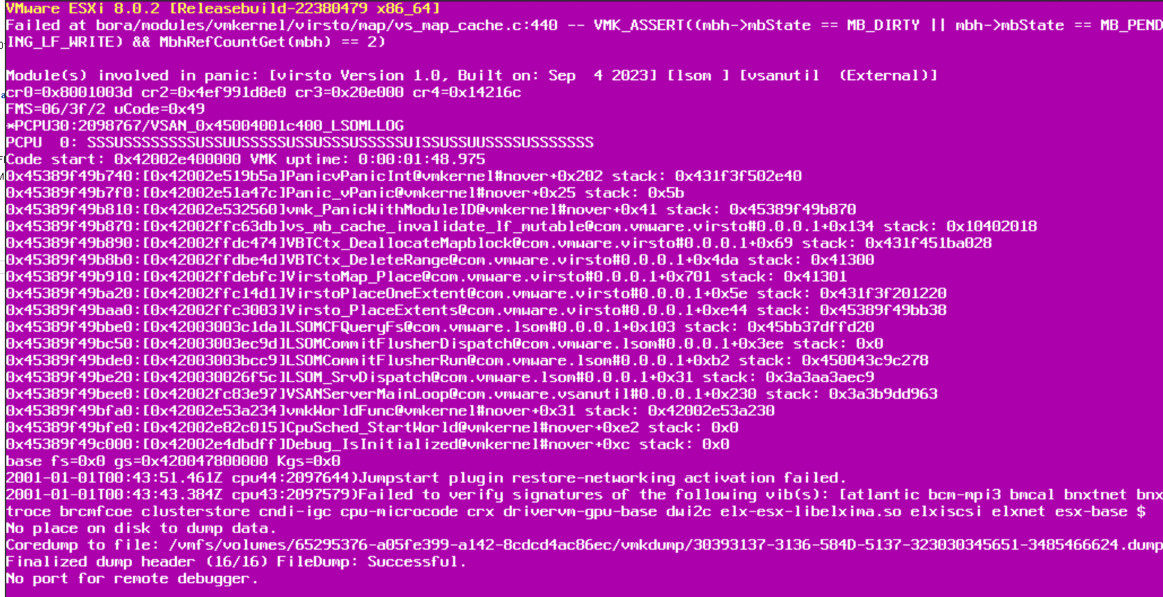

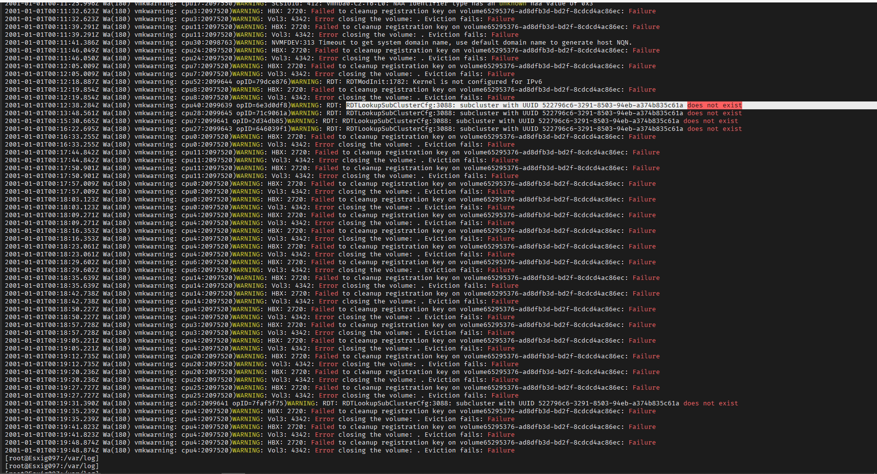

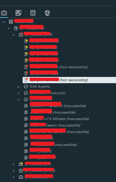

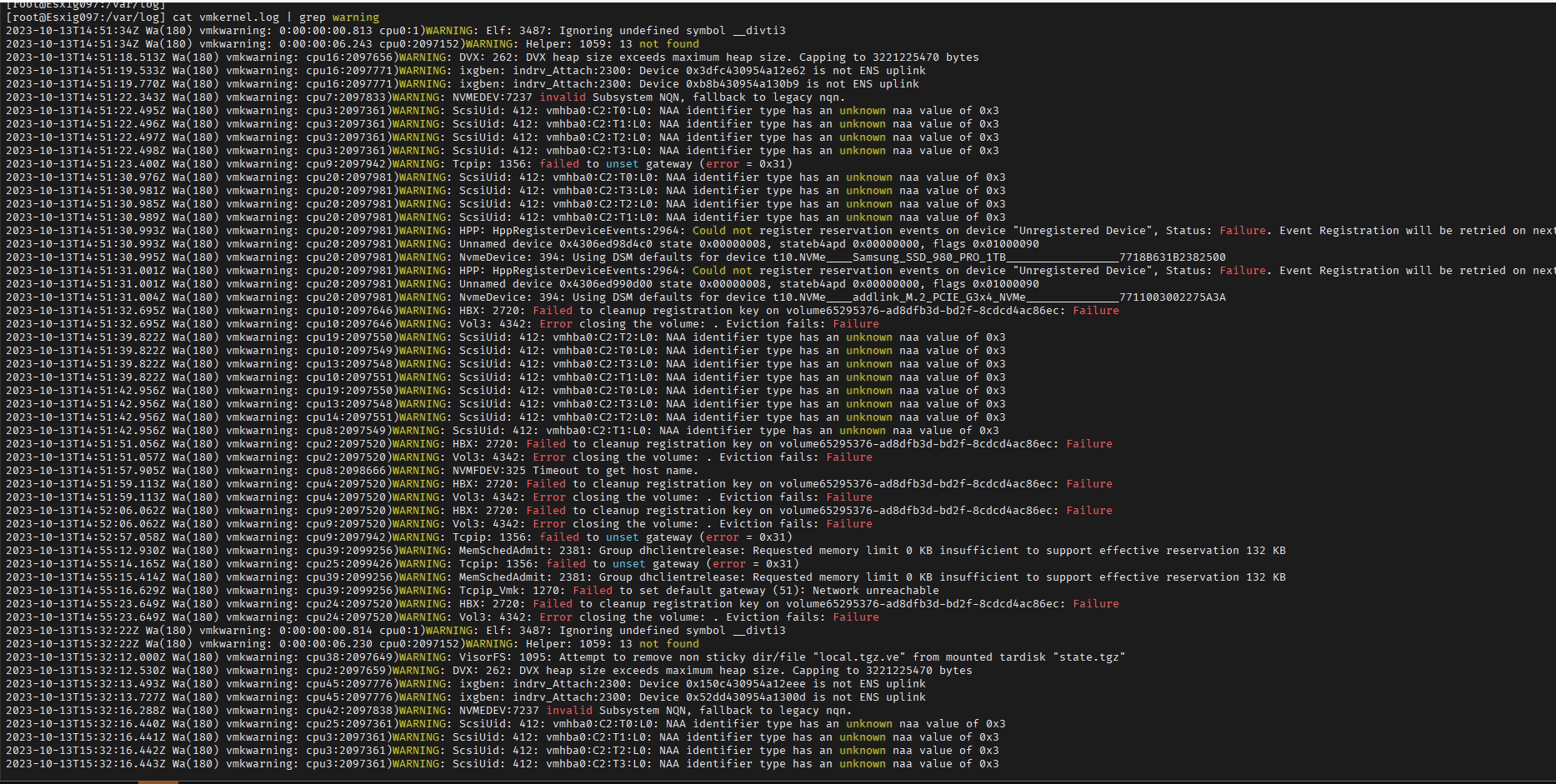

    After updating esxi to 8.0.2  (hp g9 cluster with 5 host  ) 2 host down and some vm inaccessible (lost my file)
    I put the log and pic erro here
    any body can help me (apologize for my english)
