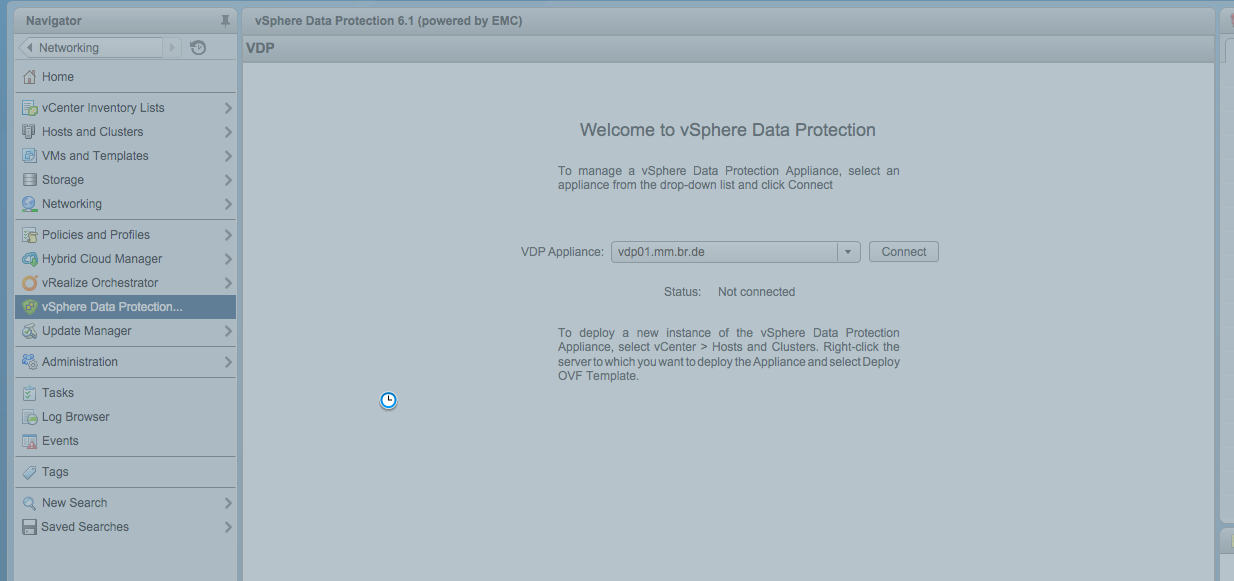

    Hi,
    I have depolyed VDP 6.1 and have it up and running. now im trying to connect to the appliance frpm vsphere Web client. After pressing connect the screen goes grey and nothing happens.
    No error message no time out, just grayed out with timeglas not moving.
    DNS is ok
    account for vdp in vcenter ok
    all services for appliance are ok
    vcenter 5.5 ESXI 5.5
    Regards
    mgd

    me too have the same problem connecting VDP 6.x through web-client, see image

    After installation, on vSphere Web Client you select VDP, select one of the appliances and then nothing happens, a watch icon shows, screen gets greyed out and it stays like that forever.
    You deploy VDP from web client, right?
    Your VDP is running on a distributed switch, right?
    If the above are correct, you may be running into a known issue.
    In order to fix this issue, please follow this procedure:
    1 - Download the attached file vdr-ui-war6.1.2.zip
    If you are using Linux based vCenter Server (VCSA) :
    2 - Log onto vCenter server using putty.
    3 - Navigate to following directory:
         cd etc/vmware/vsphere-client/vc-packages/vsphere-client-serenity/com.vmware.vdp2-6.1.0.19/plugins/
    4 - Make a note of the exact name of vdr-ui-war-*.war file.
    5 - Rename and change file extension of the existing vdr-ui*.war to war_
         Example: If existing file is vdr-ui-war-6.1.0.war, then rename existing file as vdr-ui-war-6.1.0.war_
    6 - Copy the provided newer vdr-ui-war file at the same location. Provide the same name to this new war file as that of the old war. File extension of this file will be war only (and not war_)
    7 - Restart vsphere-client service with the command:
    8 - service vsphere-client restart
    If you are using Windows based vCenter Server :
    2 - Log onto vCenter server machine.
         C:\ProgramData\VMware\vCenterServer\cfg\vsphere-client\vc-packages\vsphere-client-serenity\com.vmware.vdp2-6.1.*\plugins
    7 - Restart the vSphere Web Client services.

    Hello, I was with this same problem in my VDP 6.1.2.19 environment.
    The following solution given by VMWare now working environment.
    Hello Ney,
    I am Rui Ferreira from VMware support and i will be working with you on this VDP case.
    I didn't call you because i picked up this case today and it is Saturday.
    By looking at your case description, my understanding is that you are able to install VDP without any problem.

    Hi guys,
    we had exactly the same issues in our environment and I just want to summarize the gathered information from some blog articles (thank you all!) needed to fix the issues here:
    https://communities.vmware.com/thread/417865?start=0&tstart=0
    • This describes the missing value in the extended vApp parameter „vm.vmname“ but DID NOT fix our issue. However it may be the cause for other (customer's) problems!
    http://www.virtuallypeculiar.com/2016/05/unable-to-connect-vdp-61-to-web-client.html
    • This article led us to the „final fix“ – but as you can imagine we won’t take the risk of installing packages from "unreliable sources" in our production environment…
    After some more time of searching I found your question / link here:
    https://communities.vmware.com/thread/533954?start=0&tstart=0
    • It's some kind of unedifying that the discussion around this (imho) major incident was started several months ago and the vmware support is still struggling with advices on that,
      but the customers involved pointed out that the issues are connected to the use of distributed switches (which I couldn’t imagine so far…) - thank you all for that!
    Though the title of the linked KB article in the blog replies (29th of July) is rather misleading – and therefore hard to find for customers with that issue – it has done the trick:
    https://kb.vmware.com/selfservice/microsites/search.do?language=en_US&cmd=displayKC&externalId=2145686
    Hopefully the mentioned bug get’s fixed soon in a new VDP / vCenter release or patch and moreover I hope that the support team is able to associate upcoming issues like this with the known bug.
    It would be very helpful to have a KB article on this which is not only addressing deployment issues but issues with VDP and the use of distributed switches!
    Kind regards, pw
