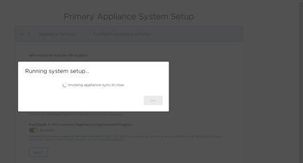

    Hi,
    I am experience issue showing below "invoking appliance-sync.sh.now, which doesn't change for hours without any sign of error.
    My setup below:
    VCD deloyed on via center HTML5 client, eth0 is set as management network and eth1 DB and both are on different subnets with NFS  share is hosted on server 2019.
    Wonder if someone would be able to assist with above issue.
    Thanks

    Hey,
    A good place to start investigating would be the /opt/vmware/var/log/vcd/appliance-sync.log file. If you have a spinning wheel then there's a good chance the error will be repeated in there.
    This is a breakdown of the logs that Cloud Director has: https://docs.vmware.com/en/VMware-Cloud-Director/10.3/VMware-Cloud-Director-Install-Configure-Upgrade-Guide/GUID-F5FA614B-611E-4794-B638-7716DEE8A6F2.html
    In your case, I'd also suggest:
    /opt/vmware/var/log/firstboot
    /opt/vmware/vcloud-director/logs/vcloud-container-debug.log
