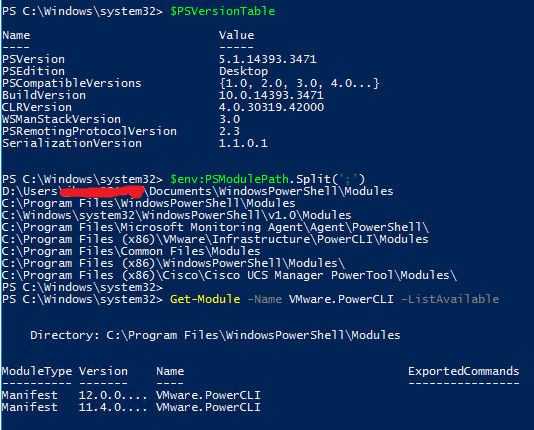

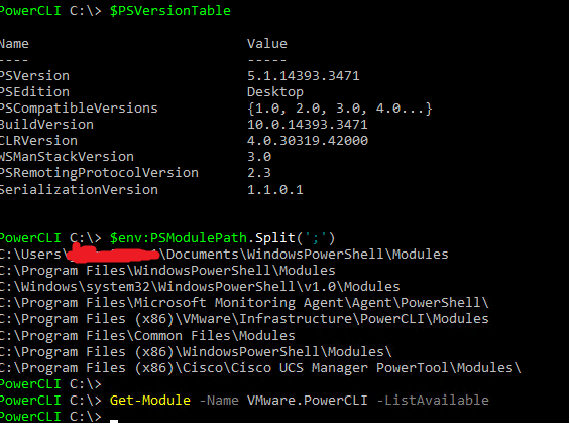

  • 6.  RE: vCheck and storing credentials for scheduled task
    Posted Aug 14, 2020 09:17 AM
    Thank you LucD.
    Please find the output.
    Thanks
    V
  • 7.  RE: vCheck and storing credentials for scheduled task
    Posted Aug 14, 2020 09:26 AM
    Looks like you might be using an older PowerCLI version.
    Most probably an MSI based installation.
    Can you upgrade?
    See Welcome PowerCLI to the PowerShell Gallery – Install Process Updates for instructions.
