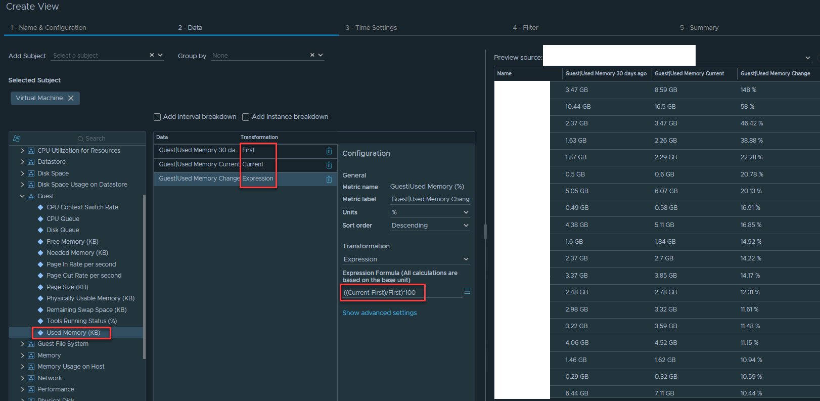

    This view may help in identifying increases by using Guest|Used Memory (KB) (requires VMtools).  Memory|Usage (%) could be used as well.
    Add the metric 3 times.  Set the transformations like below.  Time settings = last 30 days.  Filter = VM uptime greater than 30 days (newly deployed VMs may have huge spike in ram usage after powering on, want to exclude these).
