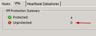

    You mean this
  • 5.  RE: Use PowerCLI to get VM HA protection status
    Posted Jun 06, 2012 06:14 PM
    Yes sir, that would be the information that I am looking for, is there a way to get that through PowerCLI?

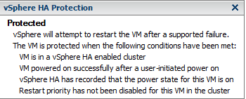

  • 11.  RE: Use PowerCLI to get VM HA protection status
    Posted Jun 06, 2012 07:51 PM
    Thought you could do this by disabling the VM Restart Priority under Virtual Machine Options is cluster settings but when I do this the VM still shows protected???
    It should not display protected if restart priority has been set to disabled but it does.
    Hersey

  • 19.  RE: Use PowerCLI to get VM HA protection status
    Posted Jun 06, 2012 10:17 PM
    I guess the point is if the VM does not meet the requirements to be protected, what is the point of reporting on it?
    VM with restart priority set to disabled is unprotected yet it reports protected.  Script does not really provide valid/useful results.
    Hersey
