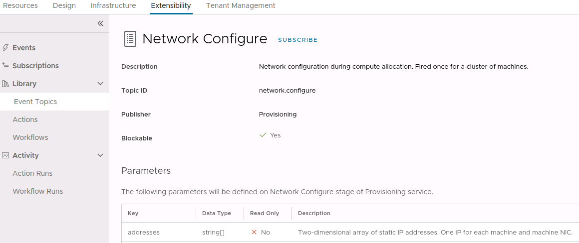

    If that's no good, I would think that what you want to do (just a request a free IP from Infoblox during a build and nothing else) should be possible if you use a Subscription on the Network Configure event.

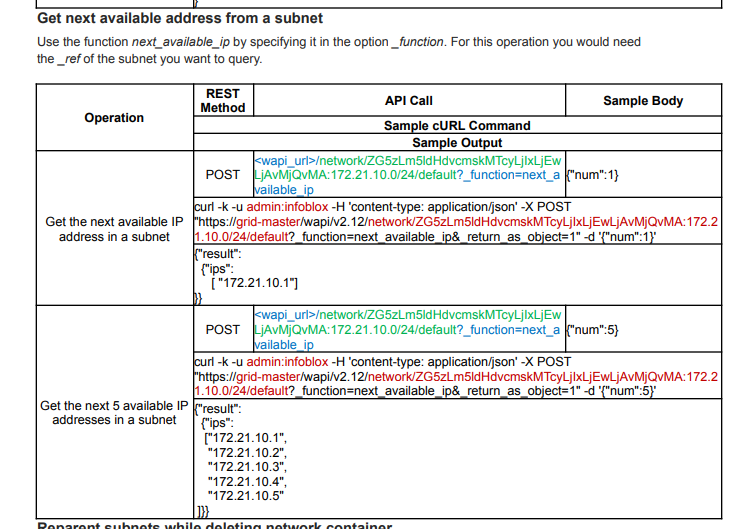

    Looking at the Infblox REST API doc (which version do you use? This might make a difference when you go to do this) there is an operation for requesting the next free IP for a subnet

    Anway, it seems like it would be possible to just replace the call to the vRA8 APIs there with the Infoblox one. To make vRA respect the allocated IP your subscription just needs to return the addresses[[]] component of the event filled in with the allocated IP. You would need to be careful around successfully mapping the network IDs in the vRA Event content to get the equivalent Subnet/Network ID in Infoblox but in general it should be doable
