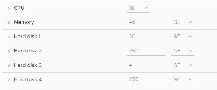

    Upgrade is running since yesterday afternoon. Is it normal this takes +12 hours?
    Both cluster nodes have below specs.

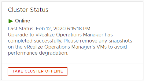

    Issue got resolved by adding another step (4).
    1. Run Assessment tool and review report.
    2. Take cluster offline.
    3. Create a snapshot of each node in the cluster
    4. Make sure the cluster is online before you do the upgrade else the upgrade gets stuck during installation.
    5. Install the product update using vRealize_Operations_Manager-VA-xxx.pak, in this case you need to use the vRealize Operations Manager 6.6.1, 6.7, 7.0, and 7.5 Virtual Appliance upgrade .pak file.
    6. Verify if upgrade is completed successfully

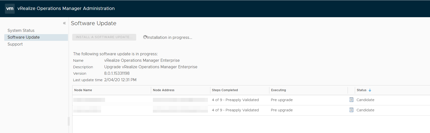

    Thank you for your remarks regarding the vrOPs update process. I'm currently doing the same, while from 7.0 to 8.1 - how long would a normal update be expected to take? I'm waiting for the completion of step 4/9 for about 2 hours by now, although having followed all the described steps.
    Thanks a lot for your kind support,

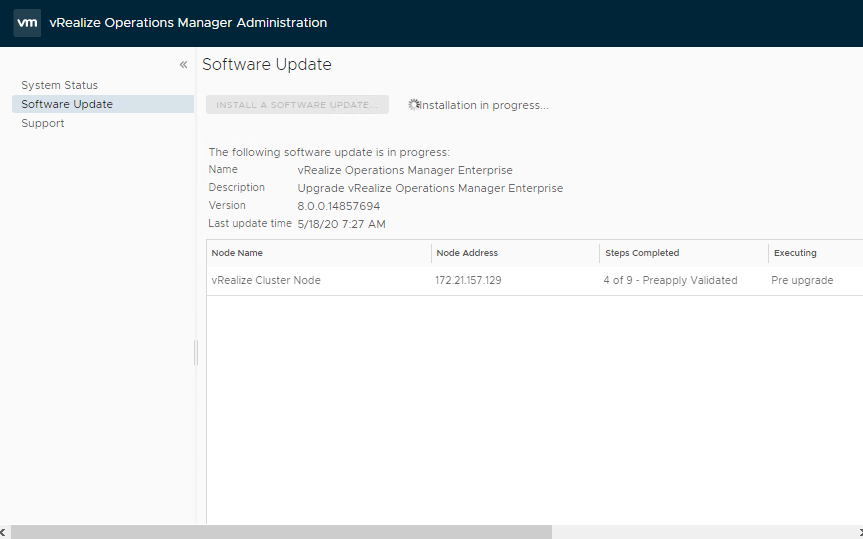

    We currently have vRealize Operation Manager 6.7.0.8183617 running. We are trying to upgrade  from 6.7 to 8.0.
    Upgrade got stuck during installation for more than 12 hours.
    4. Uploaded the VIrtual appliance pak  "vRealize_Operations_Manager-VA-8.0.0.14857694, Upgrade got stuck during installation for more than 12 hour.
    Can anyone help us to resolve this issue.
    Below is the screenshot of software update page.

    Have you got more than one ethernet connection? if so remove so you only have one connection. Additional connections can be added after upgrade.
