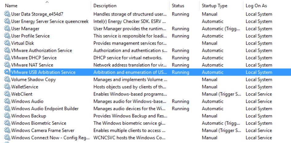

    Strange.
    The next thing to check is if the vmware usbarbitrator service is running.
    That would be a minimum requirement for usb to work in your guests.
    Wil

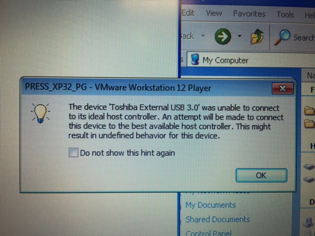

    Further Updates
    Just set up another Laptop, (intel i5 HP EliteBook 2570p running windows 7)
    Connected USB 3.0 drive to the laptop while running Windows XP Virtual Machine...
    Message popped up saying something like "cannot connect USB device to ideal USB controller... will attempt to connect to best controller but may cause unexpected functionality..."
    Then the same issue as previous (so 3 machines now!) so do I need to install something else? Is there another VM USB controller that is needed?
    Devices I am trying to connect:
    USB 3.0 1TB Toshiba HDD
    USB 3.0 1TB Verbatim HDD
    USB 2.0 16GB Verbatim Memory Stick

    Thanks Wil... checked and yes, it is running.

  • 8.  RE: Unable to use USB hard drive or USB memory stick in Virtual XP Machine
    Posted May 09, 2017 10:59 PM
    Hi,
    For USB3 your guest needs to be at least Windows 7 and you have to download a special driver from the intel website in order to get that to work.
    USB3 was not supported by Windows XP natively and as such you cannot get that to work using USB3.
    If the device is able to communicate via USB2 then you might be able to downgrade that by setting the controller to USB2 and if that doesn't work by inserting a USB2 hub inbetween device and host.
    USB2 devices however should work with Windows XP.
    Wil

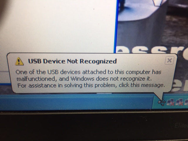

  • 11.  RE: Unable to use USB hard drive or USB memory stick in Virtual XP Machine
    Posted May 10, 2017 06:07 AM
    I've checked the USB controller setting and it is set to USB 2.0 and I even tried setting to 1.1
    i will try today to use my USB 2.0 hub and see how that goes.
    As for that vSphere thread, I hadn't noticed! Virtualisation is new to me, just trying to get some Windows XP software running for some old technology... I'm using and old laptop and if I get it all working as required I might be running several VM's... no base host is really needed so vSphere might be worth looking into.
  • 12.  RE: Unable to use USB hard drive or USB memory stick in Virtual XP Machine
    Posted May 10, 2017 09:12 AM
    As recommended by Wila, I used a USB 2.0 hub, connected to a USB 3.0 port on the laptop.
    In VM Windows XP, connected the hub to the host.
    Inserted Verbatim USB 2.0 memory stick (to hub), and it connected and I was able to read.
    Inserted Verbatim USB 3.0 1TB HDD (to hub), and it connected and I was able to read (took some time before it showed up)
    Inserted Toshiba USB 3.0 1TB HDD to a USB 2.0 port on the laptop, would not read. Got errors as shown below.
    Removed Verbatim 1TB from hub, inserted into laptop USB, would not read. Got errors as shown below.
    Put Verbatim 1TB back into hub and again, I can read (took a while to show up and connect again)
    Then this....
  • 13.  RE: Unable to use USB hard drive or USB memory stick in Virtual XP Machine
    Posted May 10, 2017 09:37 PM
    Hi,
    Not sure but it is entirely possible that when you connect the USB3 device directly into the VM that either the Windows XP stack or VMware's usb logic gets confused and ends up in a broken state that can only be resolved by rebooting the guest.
    FWIW I have never read about anybody who was able to use USB3 within an Windows XP VM successfully. Yes I have seen some claims, but I'm fairly sure that those devices simply negotiated down to USB2.
    Wil
