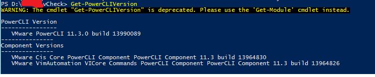

    Hi All,
    Im trying to run the vCheck health report but its throwing an error every time. Also, can we restrict to few report like vCenter,Data store, VM and Host etc...

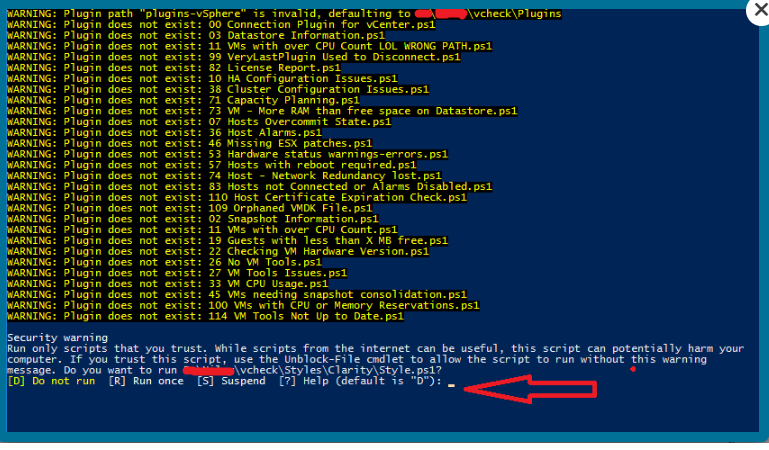

    S D:\vmk\vcheck> .\vCheck.ps1
    Security warning
    Run only scripts that you trust. While scripts from the internet can be useful, this script can potentially harm your
    computer. If you trust this script, use the Unblock-File cmdlet to allow the script to run without this warning
    message. Do you want to run D:\vmk\vcheck\Styles\Clarity\Style.ps1?
    [D] Do not run  [R] Run once  [S] Suspend  [?] Help (default is "D"): R
    WARNING:
    WARNING: Welcome to vCheck by Virtu-Al http://virtu-al.net
    WARNING: =================================================
    WARNING: This is the first time you have run this script or you have re-enabled the setup wizard.
    WARNING:
    WARNING: To re-run this wizard in the future please use vCheck.ps1 -Config
    WARNING: To get usage information, please use Get-Help vCheck.ps1
    WARNING:
    WARNING: Please complete the following questions or hit Enter to accept the current setting
    WARNING: After completing this wizard the vCheck report will be displayed on the screen.
    WARNING:
    WARNING:
    Begin Plugin Processing
    [17:57:32] ..start calculating Connection settings for vCenter by Alan Renouf v1.20 [1 of 116]
    Connect-VIServer : 12/26/2019 5:57:35 PM        Connect-VIServer                Could not resolve the requested VC serve
    r.
    Additional Information: There was no endpoint listening at https://vcsa.local.lab/sdk that could accept the message.
    This is often caused by an incorrect address or SOAP action. See InnerException, if present, for more details.
    At D:\vmk\vcheck\Plugins\00 Initialize\00 Connection Plugin for vCenter.ps1:151 char:20
    +    $VIConnection = Connect-VIServer -Server $VIServer -Port $Port
        + CategoryInfo          : ObjectNotFound: (:) [Connect-VIServer], ViServerConnectionException
        + FullyQualifiedErrorId : Client20_ConnectivityServiceImpl_Reconnect_NameResolutionFailure,VMware.VimAutomation.Vi
       Core.Cmdlets.Commands.ConnectVIServer
    D:\vmk\vcheck\Plugins\00 Initialize\00 Connection Plugin for vCenter.ps1 : Unable to connect to vCenter, please
    ensure you have altered the vCenter server address correctly. To specify a username and password edit the connection
    string in the file $GlobalVariables
    At D:\vmk\vcheck\vCheck.ps1:896 char:56
    + ... = [math]::round((Measure-Command { $Details = @(. $_.FullName)}).Tota ...
        + CategoryInfo          : NotSpecified: (:) [Write-Error], WriteErrorException
        + FullyQualifiedErrorId : Microsoft.PowerShell.Commands.WriteErrorException,00 Connection Plugin for vCenter.ps1
    Thanks
    vmk

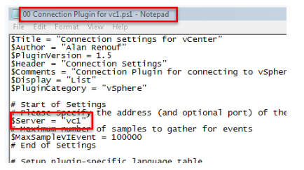

    What exactly did you change in plugin00 ?
    On line 11 you should update the value assigned to the variable $Server

    You use the one that comes with the vCheck distribution as a template.
    But you make the changes (content and filename) as I showed in the other thread.
    Then in your .xml file, you point to the plgins you want to use.
    For plugin00 that would mean the new filename you have given it.
    And no, if you go for the .xml file, you explictely name the plugins you want to use.
    Then you do not need to use Select-Plugins.ps1.

    2) But each time its prompting to give input Example - R or D input. how to avoid or skip this ? And its keep prompting me in the middle of job to press D/R/S.

  • 21.  RE: Unable to run the vCheck health report
    Posted Dec 30, 2019 07:41 AM
    1. Yes
    2. That is your ExecutionPolicy, which is a PowerShell setting. Use Set-ExecutionPolicy, with the correct Scope, to set it once and for all.

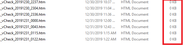

    Report is showing 0KB size though its successfully executing. Any idea why ?

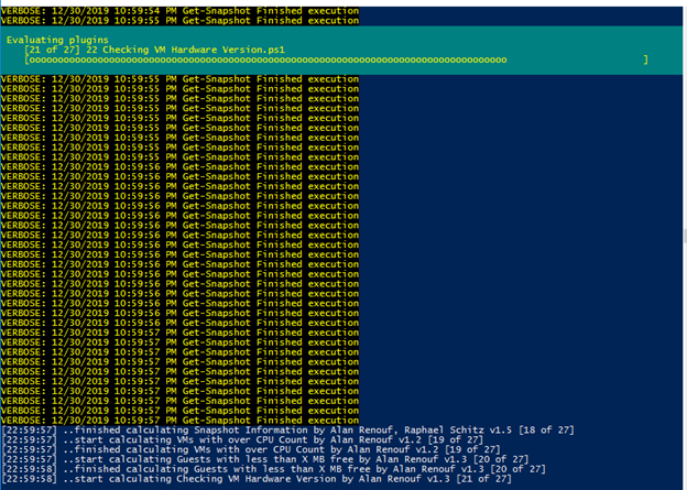

    That could mean that the script is not connecting or unable to retrieve data.
    You could try adding the -Verbose switch when calling vCheck.ps1.
    Perhaps that gives some clues what is going on.

    Do you still receive the report on screen?  - Yes
    Does that have any content?  No content in html file. 0 KB size

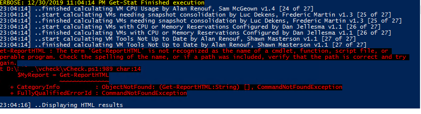

    The Get-ReportHtml function is defined in each of the styles.
    What do you have as value for the $Style variable in the GlobalVariables.ps1 file?
    That should be one of the following: Clarity,CleanGreen or VMware

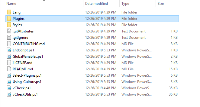

    Are you missinnng the Styles folder or any of the folders/files in there?
    Perhaps try using one of the other available styles, like VMware or CleanGreen.

    Yes, all the three folder are there.

    Did you try any of the other available styles as I suggested?
    I assume all vCheck related files are unblocked?
    See How to Unblock a File Downloaded from an Email or the Internet – Support Center

    Posted Dec 30, 2019 07:39 PM
    Did you try any of the other available styles as I suggested? - Ok i changed the style to VMware and running again
    I assume all vCheck related files are unblocked?  - yes it will not allow to execute.
    I also noticed that $email is again set to $False. - No purposefully. Do want me to change to true ? Please confirm. which line need to change,
    Was that on purpose?  No
    Screen display  shows after changing the style also-
    00:43:47] ..finished calculating VM Tools Not Up to Date by Alan Renouf, Shawn Masterson v1.1 [26 of 26]
    et-ReportHTML : The term 'Get-ReportHTML' is not recognized as the name of a cmdlet, function, script file, or
    perable program. Check the spelling of the name, or if a path was included, verify that the path is correct and try
    gain.
    t D:\vmk\vcheck\vCheck.ps1:989 char:14
         $MyReport = Get-ReportHTML
       + CategoryInfo          : ObjectNotFound: (Get-ReportHTML:String) [], CommandNotFoundException
       + FullyQualifiedErrorId : CommandNotFoundException
    thanks
    vmk

    There must be something wrong with the loading of the style file (Style.ps1).
    Since other files, like plugins, seem to load fine, I don't have an immediate explanation why that happens.
    Setting $Email to $true won't help a lot, since the HTML file empty.
    And that is because the Get-ReportHtml function is not found.
    You could try using a transcript, to check if that shows any further clues.
    Add the following just before line 71 in vCheck.ps1
    Start-Transcript -Path .\transcript.txt

    Posted Dec 31, 2019 05:41 AM
    LucD,

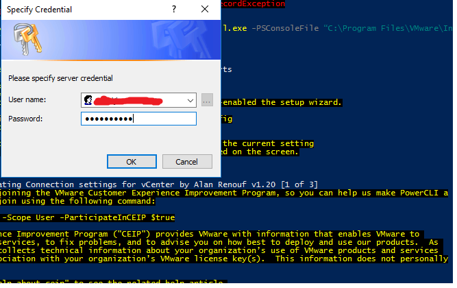

    It appears it working. I unblocked all the files under styles folder after seeing the styles file showing unable to load and not trusted. I have called the job.xml file
    and tried but its prompting me window for credential and earlier it never prompted for credential window but its generating the report. Please help me to fix or skip the credential window because i'll be running scheuler tasks later. Also, i'll try with maximum plugin now and will let you know.
    thanks
    vmk
  • 39.  RE: Unable to run the vCheck health report
    Posted Dec 31, 2019 05:59 AM
    If you are running this from a Windows station, you might use the New-VICredentialStoreItem.
    Create an entry for each vCenter you want to run vCheck against.
    Then the Connect-VIServer cmdlet will pick up the credentials from there.
    Make sure that the VICredentialStoreItem entries are created with the same account that will run vCheck and on the same station.
    The cmdlet uses DPAPI, and the encryption is unique to the user and station.

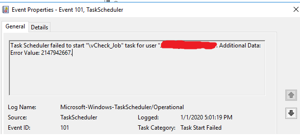

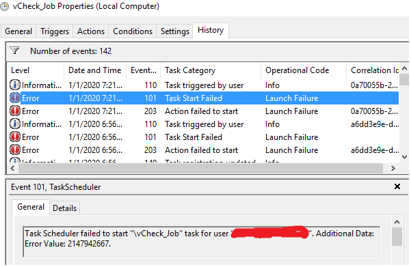

    Email issue is fixed. I'm receiving the mail for report. Now schedule tasks i ran with the following link shared by you but its keep failing with
    ask Scheduler failed to start  task for user. Additional Data: Error Value: 2147942667.
    Hence, i decided to execute through batch file and its gives following error.
    still same error. ( see above screens shot)
    Do i need run store item credential each time whenever i login to power cli.  because its prompting me credential next day when executed the script again.
    thanks
    vmk

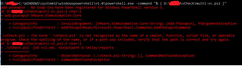

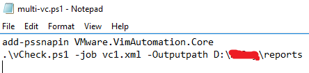

    Where is that Add-PSSnapin cmdlet coming from?
    That is not needed, provided you are running at least PowerCLI version 5.8R1.
    Which PowerCLI version are you using?
    No, those VICredentialStoreItems are stored in an external file, and you shouldn't need to re-enter the credentials.

    Posted Jan 01, 2020 01:13 PM
    LucD,
    Thank you for help. Only Task scheduler left now which will make my job easy
    Where is that Add-PSSnapin cmdlet coming from?  Tasks scheduler cant see any error, hence I tried to test via batch file.(bat file)
    Through task scheduler i get the error
    Which PowerCLI version are you using? 11.3
    Also, add-pssnapin VMware.VimAutomation.Core where i need add ? do i need add to all plugin ? or only vCheck.s1 only ? I have added to multi-vc.ps1 which is calling vc.1xml file.

    Posted Jan 01, 2020 01:35 PM
    With your version of PowerCLI 11.3, you do not need a Add-PSSnapin line.
    I can't tell from that error code what goes wrong with the Task Scheduler.
    I would need to see the Task Scheduler job definition.

    Posted Jan 01, 2020 01:50 PM
    LucD,

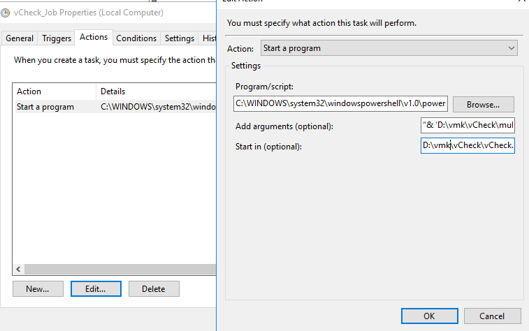

    Ok i have attached screen for task scheduler definition. Also, i'm running against vCenter 5.5, hope that doesn't make any issue.
    C:\WINDOWS\system32\windowspowershell\v1.0\powershell.exe
    After your suggestion, i have removed add-pssnapin from multi-vc.ps1
    Start in - D:\vmk\vCheck\multi-vc.ps1

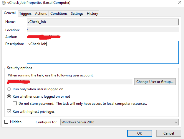

    What is in the General tab? User account?

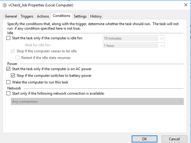

    There don't seem to be any arguments.
  • 48.  RE: Unable to run the vCheck health report
    Posted Jan 01, 2020 02:08 PM
    Sorry, forgot to share. Also, i have enabled log on as a batch job from local security. User is part of admin group.
    Any other way to automate the report ? in case if task scheduler is not working. I'm not giving up.
  • 49.  RE: Unable to run the vCheck health report
    Posted Jan 01, 2020 02:38 PM
    • Did you create the VICredentialStoreItem with that same user you specified in the Scheduled Task? Remember, these entries only work for the same user on the same station where they were created
    • You didn't seem to specifiy an argument for the powershell.exe. That is where you normally would provide the script and it's parameters (as the post I pointed to earlier explains).
    • That return code from Task Scheduler (0x8007010B) might be caused by the value in the Start in field. See https://stackoverflow.com/questions/13618945/why-windows-7-task-scheduler-task-fails-with-error-2147942667

    • Did you create the VICredentialStoreItem with that same user you specified in the Scheduled Task? Remember, these entries only work for the same user on the same station where they were created  -Yes, i'm using the same id.
            I have added now - C:\WINDOWS\system32\windowspowershell\v1.0\powershell.exe “& ‘D:\vmk\vCheck\multi-vc.ps1′”  See below
    • That return code from Task Scheduler (0x8007010B) might be caused by the value in the Start in field. See - Yes, i have removed the double quotes from Start(optional)
    thanks

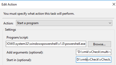

    Can you try with the argument just as
    “D:\vmk\vCheck\multi-vc.ps1”
  • 56.  RE: Unable to run the vCheck health report
    Posted Jan 01, 2020 05:30 PM
    No luck. It's same error.
    Task Scheduler failed to start "\vCheck_Job" task for user "xyz\vmkxyz". Additional Data: Error Value: 2147942667.
    thanks
    vmk

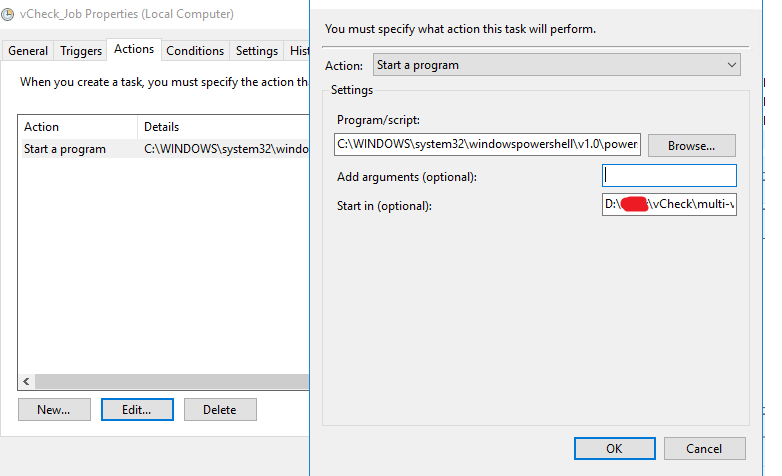

  • 57.  RE: Unable to run the vCheck health report
    Posted Jan 01, 2020 06:04 PM
    Also replace the value in Start in with
    D:\vmk\vCheck\
    No quotes, no file, just the folder

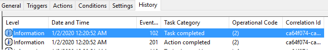

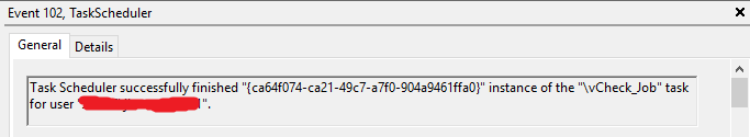

    At last something moving, but still some more challenges its seems. There was no error this time and the task completed successfully without any errors, but no report generated  :smileysad:.  I did check in folder reports but no report file. Any idea ?
    thanks
    vmk

    Posted Jan 02, 2020 01:49 PM
    Sure, Do i need add this line to vCheck.ps1 or multi-vc.ps1 (call vc.xml) ?
  • 63.  RE: Unable to run the vCheck health report
    Posted Jan 02, 2020 01:58 PM
    As early as possible, try in multi-vc.ps1
  • 64.  RE: Unable to run the vCheck health report
    Posted Jan 02, 2020 02:18 PM
    ok i did and i didnt see any output. Does it mean its not running ? But tasks scheduler not giving any error.

  • 65.  RE: Unable to run the vCheck health report
    Posted Jan 02, 2020 02:36 PM
    There can be many reasons why the scheduled task is not running correctly.
    Does it still return an error code?
    There are a number of fiagnostic steps described in https://stackoverflow.com/questions/865653/how-to-troubleshoot-windows-scheduled-task-not-running
  • 66.  RE: Unable to run the vCheck health report
    Posted Jan 02, 2020 02:44 PM
    you might be right, one thing  i noticed when i ran the script from power cli console, it keep prompting for password after couple of seconds though i have stored password using New-VICredentialStoreItem. Note - I'm running job.xml which have report for 2 vc and it prompting always for 2nd vc. Does it mean job parameter we can call only one job at a time ?
    I'll still your link for schedule tasks troubleshooting. right no error code showing. I'm really feeling bad that the thread is going forever.
    Task Scheduler successfully completed task "\vCheck_Job" , instance "{957ea9b2-e76c-4da5-9ed3-3e2444d08c7a}" , action "C:\WINDOWS\system32\windowspowershell\v1.0\powershell.exe" with return code 0.
    thanks
    vmk.
  • 67.  RE: Unable to run the vCheck health report
    Posted Jan 02, 2020 03:04 PM
    Yes, since you can only point to 1 plugin00 in the .xml file, you need a job .xml per vCenter.
    You can have multiple VICredentialStoreItems, one per vCenter  (via the Host parameter).
  • 68.  RE: Unable to run the vCheck health report
    Posted Jan 04, 2020 12:19 PM
    LucD,
    Finally, i was able to fix the vCheck report through Task scheduler. Your earlier thread helped me not sure its exact reason
    vim.psc1 missing from 6.5 install?
    so Add Arguments just shows: -File "Location of your scirpt \vCheck.ps1"
    After the -File and removing the job.xml it working and sending report. It's seems xml parameter doesn't work with Task scheduler.
    thanks
    v
  • 69.  RE: Unable to run the vCheck health report
    Posted Jan 04, 2020 02:07 PM
    There is also an open issue on the vCheck repo mentioning issues with Task Scheduler.
    I'll add that to the list of new features for new version we are preparing.
