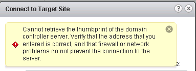

    I'm creating a replicated scenario were two sites involved. Both are running vSphere 6 with a separated vCenter installation. Both are using the same Active Directory as a identity source within SSO. Both sites are licensed with Essentials plus which includes vSphere Replication. When I try to setup replication between the both, I got the following error message:
    I think i got the message because both sides are using the same AD as a identity source within SSO. How could i solve this?

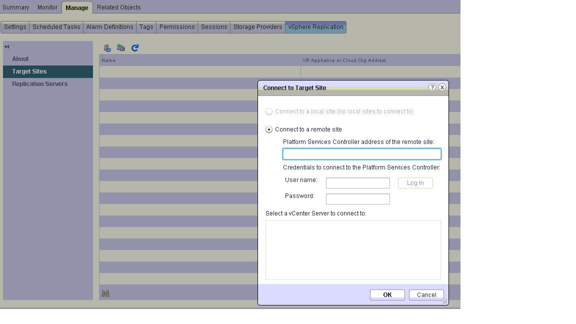

    They are not using the same SSO Domain, but are using the same active directory. This is because using the Essentials Plus license which with previous releases couldn't be using Linked Mode.
    There are two sites, with two implementations of the VCSA which are both using there own SSO domain, but are using both the same Active Directory domain. When trying to connect to a local site the following is showed:
    I have checked the ports and they are opened, when trying to setup a telnet session from the ESXi host to the VRP appliance the connection timed out. When trying from an other station the telnet to VRP works correctly. On the ESXi host the HBR ports are active and opened.

    So first if you have a two separate SSO domains  "Connect to a remote site" is the correct option exactly as it is on your screen shot.
    Next step is to type correctly IP/FQDN of the server on the target site where PSC is running...for successful registration with target PSC
    you need credentials of the DR site SSO domain user who has VRM remote.Manage VRM priviledge assigned (i.e. -> VRM administrator User Role).
    The last but not least step is to verify that traffic between ESXi host (its VR agent) on primary site  to VR Appliance at DR site is routed properly ...
    By default vSphere Replication is using ESXi management interface to send replication traffic to the VReplication appliance on the DR site. (its also possible to separate VR traffic from mgmt network)
    Please post hbrsrv.log and hms.log
