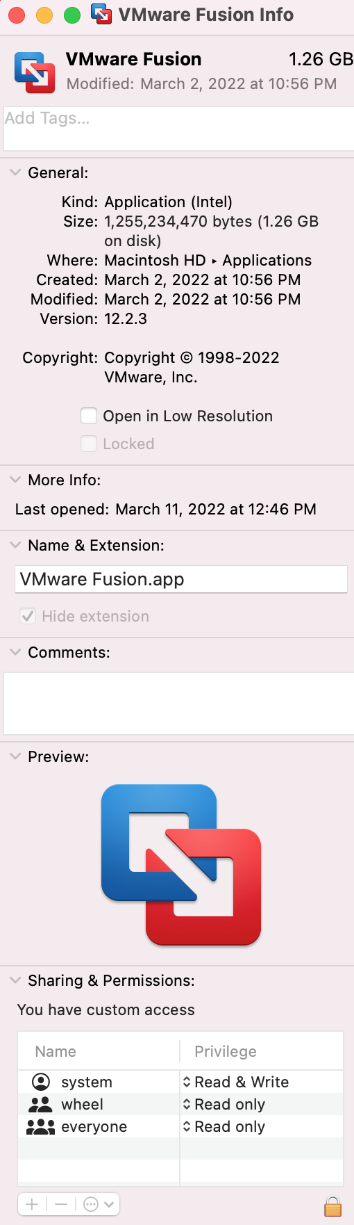

    Posted Mar 11, 2022 08:59 PM
    screenshot of vmware fusion info window.png   oh... i should also mention that one of the many thhings i tried (2 days ago) was changing priviledges using sudo commands. i enabeled full access to everyone but error still occured.
    here im showing hte current settings , after i did fresh install of fusion last night
      do you think my problem has anything to do with the permissions or ownership?

    You should never have to use sudo on the mac for anything.  If you've installed and are running Fusion as an administrator, it should be fine.
    whatever you do, don't set a root password!

    sudo can get you into a lot of trouble. Apple is not only setting UNIX permissions but ACLs, flags, and other undocumented metadata in the file system these days. Hard to make sure you don't shoot yourself in the foot.
    And to setting a root password, I quote the esteemed Egon Spengler responding to why to not cross the streams:  "It would be bad".

    i see some ownerships of files as 'wheel' , was that the result of me running sudo commands
    should i change ownership back to 'admin'?  not sure if that is related to having a root password set
    how can i confirm that i dont have a root password set?
