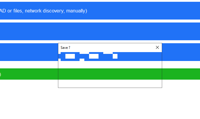

    I have the same issue. I have more than 16 base vms, with countless snapshots states. All of them behave the same way after updating to 17.6.X. Installed latest vmware tools and still not working properly.
    Had to roll back twice to 17.5.2, since I had hopes that this was fixed on 17.6.2.
    Screen rewrite when opening windows, or images, will shows rectangles with missing part of the image. Some windows wont fully refresh until interacting with it. Scrolling on large text/code files will partially refresh some lines and not others, making it impossible to review code.
    This is one example screenshot of the video glitch.
    If anybody can confirm that his is fixed in new versions, let us know. For now I'm done updating and downgrading.

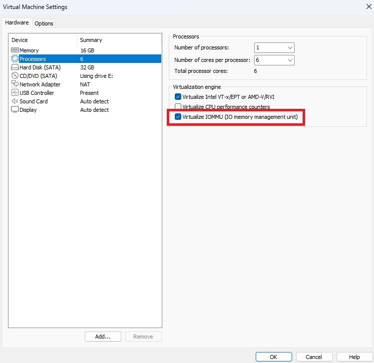

    Regarding the Windows 11 VM boot error (BSOD), I tested it by changing various settings and confirmed that it only occurs when the Virtualize IOMMU option is turned on. This is still not resolved in the current version (17.6.3).
