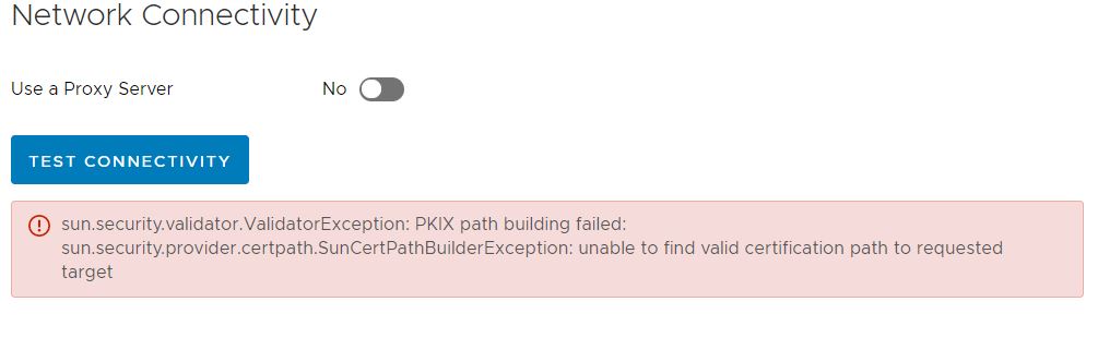

    Hello, I was having issues with the collector connecting to skyline services so I decided to deploy a new appliance and now I get this error

    Skyline Collector uploads encrypted product usage data to VMware over the Internet. If required by your organization, an HTTP proxy server can be configured between Skyline Collector and the Internet.
    Below is the External Network Connectivity Requirements
    Machine                                           Connection To                                       Connection Type                       Protocol                Port
    VMware Skyline Collector           vcsa.vmware.com                                         HTTPS                                    TCP/IP                 443
    VMware Skyline Collector           vapp-updates.vmware.com                         HTTPS                                    TCP/IP                 443
    Kindly confirm if we are able to reach the about 2 URLs from Skyline collector and if the required ports are open. If we need to use proxy server,  kindly enable proxy.

    Hi Jarrox,
    i have fixed the same issue yesterday. I have to disable ssl decryption on our palo alto firewall for the collector ip.
    Best regards,
    Chris
  • 4.  RE: sun.security.validator.ValidatorException: PKIX path building failed
    Posted Nov 14, 2019 12:36 PM
    This was this issue, but I do not believe they disabled it just maybe excluded the IP.
