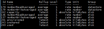

    When running the function with the switches mentioned above ($dsreadrate = Get-Stat2 -Entity $dsdata -Stat "datastore.read.average" -Start $start -Finish $end) it returns this error.
    When trying this command: "get-stat2 -entity $ds -interval "HI2" -stat "datastore.read.average" -queryinstance" I get nothing.
    Heres the metrics I retreive when running this command: "get-stat2 -entity $ds -interval "HI2" -QueryMetrics | ft -AutoSize"

    But, it seems that there are some changes in the metrics names.  When adjusting a little on the command the line below, at least, I don't get any error...in fact...I get nothing...
    get-stat2 -Entity $ds -interval "HI2" -Stat "datastore.numberReadAveraged.average"

    Get-Stat2 -entity $ds -interval "HI2" -QueryMetrics | ft -AutoSize  ## OK
    Get-Stat2 -Entity $ds -Stat "datastore.read.average" -Start $start -Finish $end  ## This doesn't work! See error message

    The default interval is the RealTime interval (RT), but the datastore metrics do not exist in that interval.
    Add the Interval parameter.
