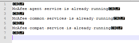

  • 11.  RE: Split output in multiple lines
    Posted Aug 30, 2021 12:07 PM
      |   view attached
    Hi LucD,
    I hereby attached the output, I see below output
    Attachment(s)
    txt
    output235.txt   270 B 1 version
  • 12.  RE: Split output in multiple lines
    Best Answer
    Posted Aug 30, 2021 12:28 PM
    If that is the actual content of $result.Output, try with this
    $result.Output.Replace("`r`n",'|').Split('|').Where{$_ -ne ''}
    The reason for the Replace is that a Split only works on 1 character at the time, not a string
  • 13.  RE: Split output in multiple lines
    Posted Aug 30, 2021 03:05 PM
    that worked perfect!!! Thank you very much
