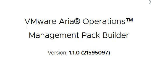

    1. What version of MP Builder are you using? What version of the Veeam API?

    The MP builder is at the latest version. 1.1.0.

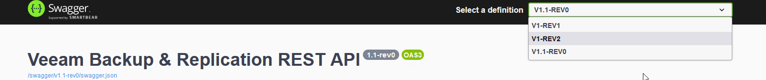

    I actually have 3 API versions for Veeam. But this is not an issue with the Veeam API. It is responsive. I've tried this connection from a linux box, from Windows using PowerShell and from Postman. All are successful.

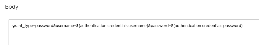

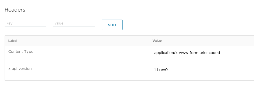

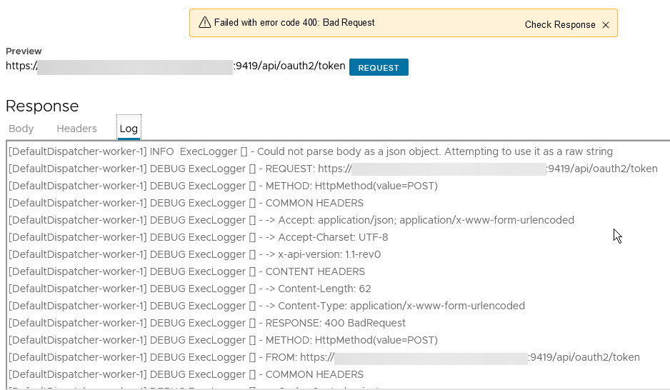

    This is the Content-Type:
    The 3rd party blog is referenced by VMware documentation - Management Pack Builder - VMware Technology Network VMTN
    The builder wants to parse the body as JSON and it fails. It even does so when I enter valid JSON. I tried all possible combinations, but it just send the body as raw string.

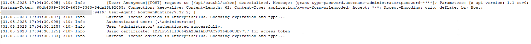

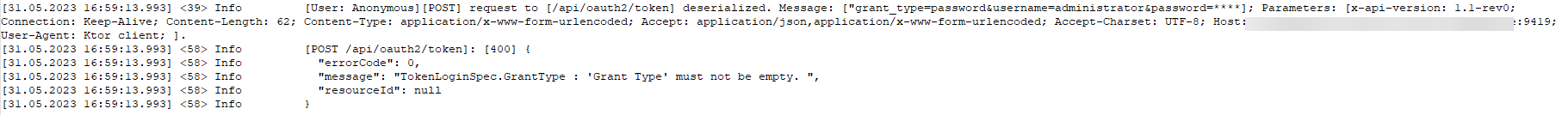

    This is the API log.
    The same call done from Postman has this in the API log:
    I do not understand how should I write this bit, in order for the parser to not error out.

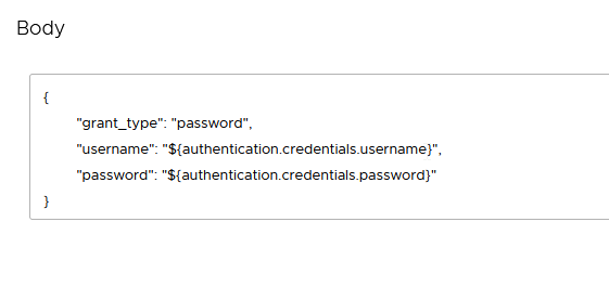

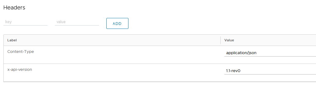

    For anybody that has this issue. I managed to make it work by changing the content-type.
    Although the Veeam documentation asks for the content type to be set as application/x-www-form-urlencoded, just set is as application/json
    The body needs to be a valid JSON.
    This will work.

    Strangely, we were not able to reproduce this issue in our lab. The log about "Could not parse body as a JSON object" is not an error, it's expected behavior for any non-JSON content type (it is misleading; we will look at rewording). And the API's response that grant_type was not specified is also strange - you clearly specified it.
    Our best guess is that maybe there was a special character in the password that needed to be url-encoded, thus breaking the entire body of the request.
