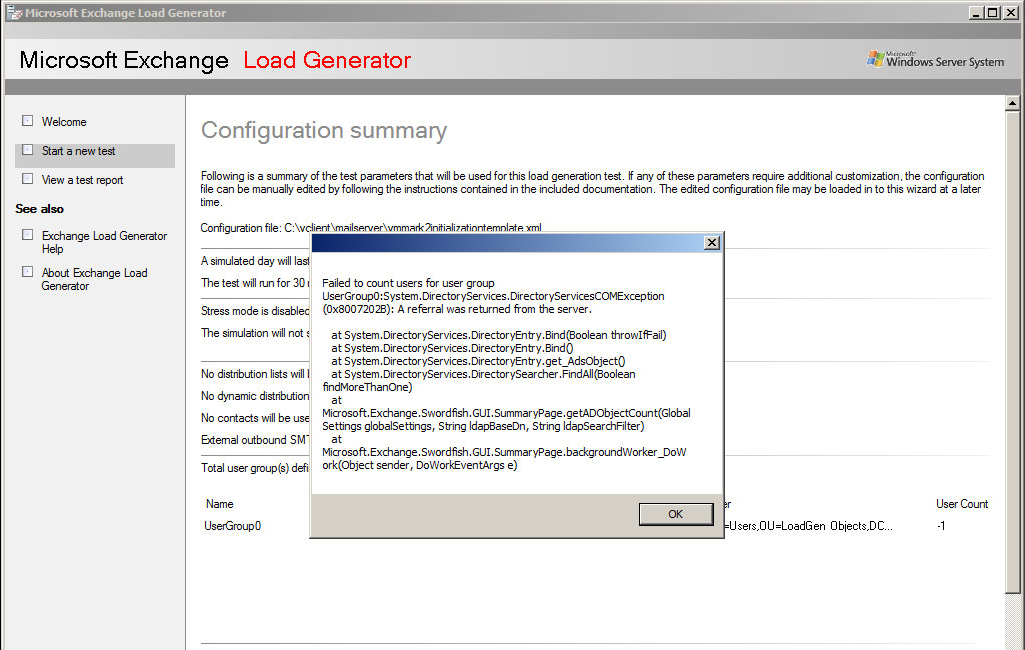

    I tried to setup the LoadGen
    But I got this error message
    Is it something wrong with my setting??
    Thanks
    Alvin

    Hi Alvin, it looks like you resolved this by reinstalling the Exchange Server Management tool on the client as seen here, correct?

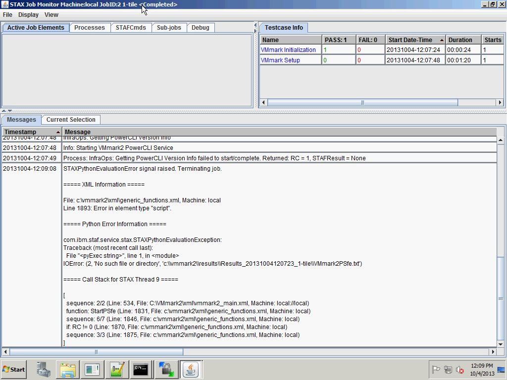

    Hi Rebecca,
    New problem...:smileysad:
    Is there something wrong in the script??
    Thanks for your help!!
    Alvin

    Did you unblock VMmarkPScli.ps1?
    1 On the Prime Client, navigate to the VMmark2\tools directory.
    2 Right-click the VMmarkPScli.ps1 file and select Properties.
    3 At the VMmarkPScli.ps1 Properties window, under the General tab, click the Unblock button.
    4 Close the VMmarkPScli.ps1 Properties window.

    Hi Rebecca,
    It works!! Great.

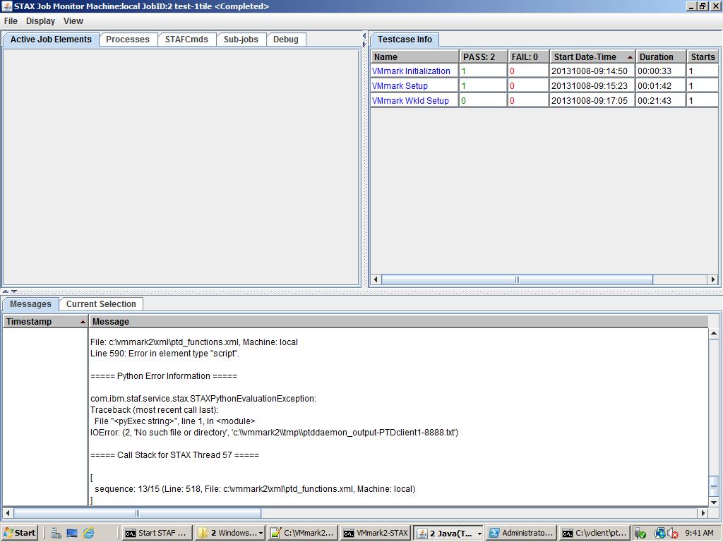

    Issue 1:
    Error: VMmarkRMQmgr Unable to Clear Queues
    And I also stuck in the middle of the test
    Please give me some suggestion about my incorrect settings
    Thanks a lot!!  :smileycry:
    Alvin

    Your file RMQmgr-out.txt shows the error "The system cannot find the path specified". This is probably due to a missing or misnamed file or directory.
    Is this file present on your prime client?
    C:\VMmark2\tools\VMmark2-RMQmgr.pl
    Also, is this exactly the description of the run that you specified? "1-tile-test" If your run description includes illegal characters (e.g. \ / : * ? | > < ) the illegal characters may not show up in the run results folder, but can still create problems for the run and can produce the above error.

    BUT something new happened!!
    I have a question
    In the VMMARK2.CONFIG
    For example PTD=1
    Does it mean I disable the PTD function?
    I already marked all the PTD related lines in the CONFIG
    But STAX still ask me for the PTD client host
    Alvin
  • 25.  RE: Some questions from the Benchmarking Guide.
    Broadcom Employee
    Posted Oct 08, 2013 05:20 PM
    Ok, instead of commenting out the line PTD=0, uncomment it. PTD=0 means that PTD is not running.
  • 26.  RE: Some questions from the Benchmarking Guide.
    Posted Oct 08, 2013 05:37 PM
    The config file confused me..
    PTD=0/1: Valid values [0/1] Enable/Disable
    0: Enable
    1: Disable
    Thanks..
    Alvin
  • 27.  RE: Some questions from the Benchmarking Guide.
    Broadcom Employee
    Posted Oct 08, 2013 05:46 PM
    Good point, I can see how that is confusing. We will fix that.
