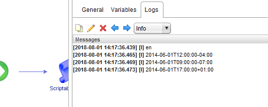

    Had another crack at this and got it working
    Here's the workflow code & output

    Output in the log trace looks like this
